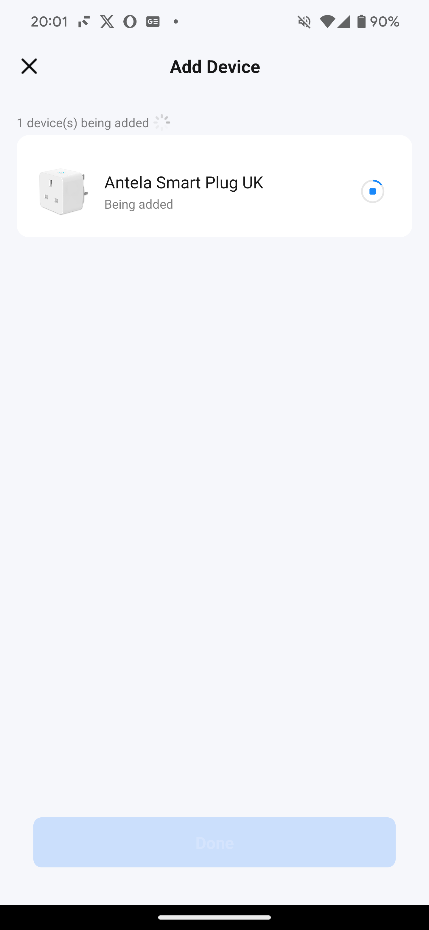

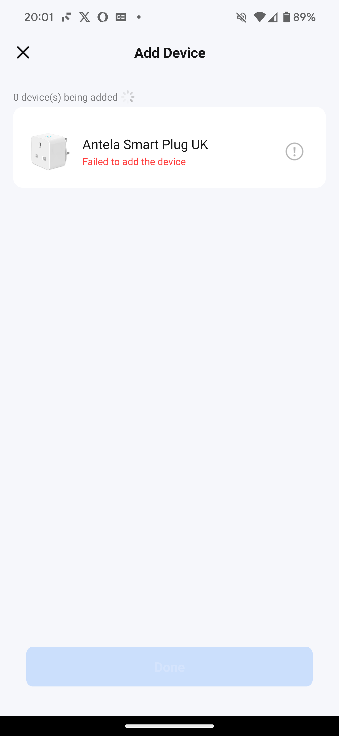

      Hi Martin, (hopefully) as you can see the app identifies the device and begins the connection process then fails. I've managed to arrange for a Virgin Media engineer to come tomorrow and look at the issue, hopefully it's an easy fix as I have things which can't be easily changed and we're working fine timm the switch over.
