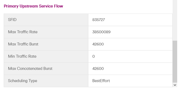

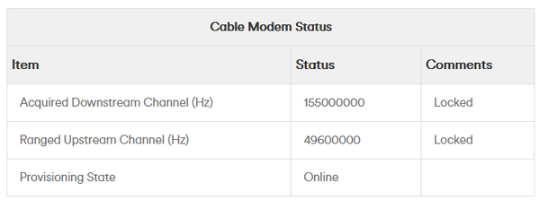

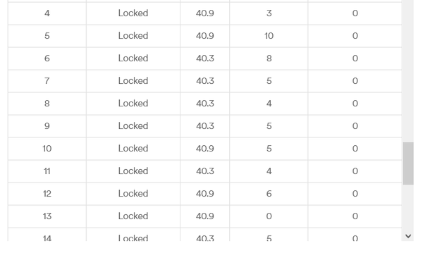

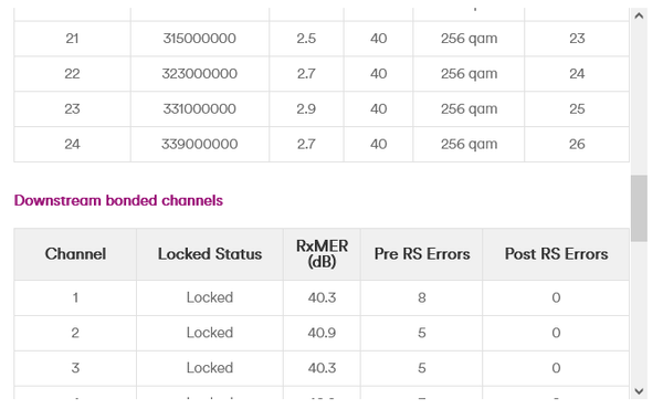

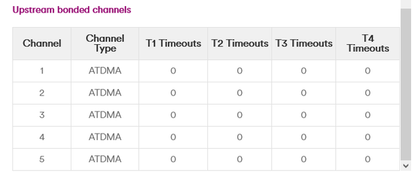

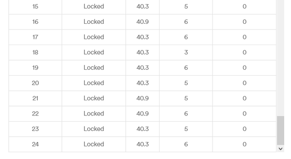

      • elyuw's avatar
        elyuw

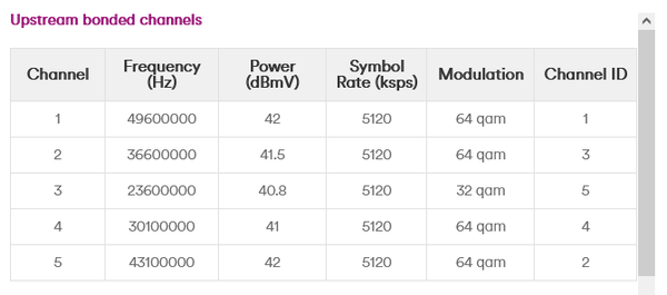

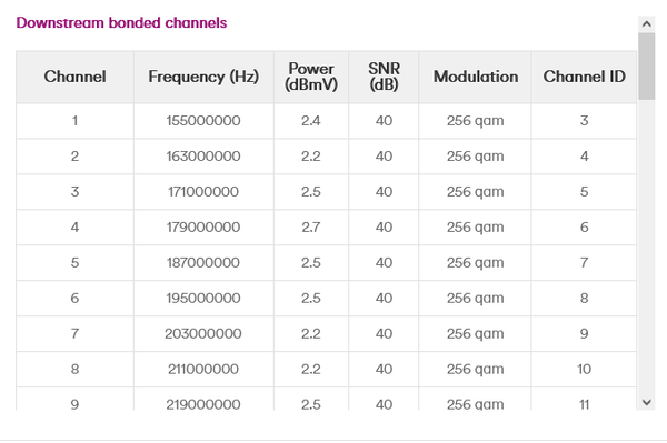

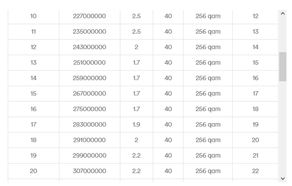

        Re: SLA and Working from home. I understand all that, but it's been rock solid since March 2020. So I'm not making rash decisions just yet. The backup is hot-spotting to my 4G/5G phone. But yeah, I've looked into getting a separate WiFi router.
        I've setup BQM after today's outage. That's here;
        https://www.thinkbroadband.com/broadband/monitoring/quality/share/3d65afa1b70e85a3dbd41260add91b6c5b6dfcb1
        Attached are all the logs etc. The ATOM Kernal panics are not a good look, but a quick search suggest this is the norm for a VM Hub 3 :/
        Thanks for your interest and future help.
        Mod Edit : Personal information removed
