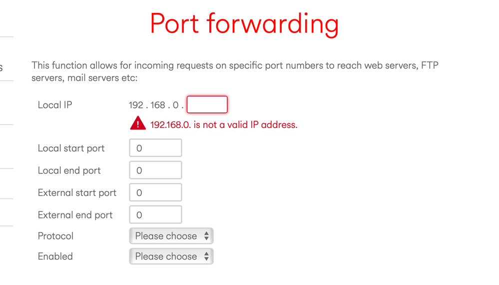

I'm trying to configure my new WD External Hard drive but it is automatically in relay mode which is restricting its use.
WD have advised me the router needs to enable Port Forwarding but I do not know how to do this - I have a Hub 5 - can I get help from Virgin Support?
Thanks!
8 Replies
  • Ok - so I've found where to access port forwarding.
    I do know the IP address of the WD device .
    What I don't know is what to add for all the other fields on this screen. Any ideas?

      You probably need to set up two port forwards..
      Should be:
      Local IP - you know what this is, put the last octet of the address in the field
      Local start port: 80
      Local end port:80
      External Start port: 8080
      External endport: 8080
      Protocol: TCP
      Enabled: Yes
      Then the same again but:
      Local start port: 443
      Local end port:443
      External Start port: 8443
      External endport: 8443
      When accessing the device from outside your network (i.e. over hte internet) then you would go to https://your.ip.address:8443 or http://your.ip.address:8080

    • ColFB's avatar
      ColFB
      Read again - I DO know the address of the device... It's obvs not in the pic, but I know that I can type that in when I get there.

    I guess VM really have made router mode complicated to use.
    Put in the ports WD say to put in if one port the same for start and end or a range

    I have WD MyCloude Home (It is the Network Drive), everyting was working just fine on BT. I had VM installed yesterday and now I can not connect to the drive at all.
    I tried the suggestion above forward port, but it did not work,
  • jpeg1's avatar
    jpeg1
    You'll need to set the WD device to a fixed IP.  And you'll need to know your WAN IP, which on VM will change unless you use DDNS.
