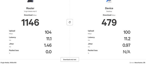

Samknows speedtest tells me my speeds to the Router are fine (which is what I'm paying for technically) - but ethernet internet speeds are nowhere near 1Gbps.  I tried from my normal PC and laptop (that do go via an unmanaged switch) but I've now connected directly to the Hub and it's the same.

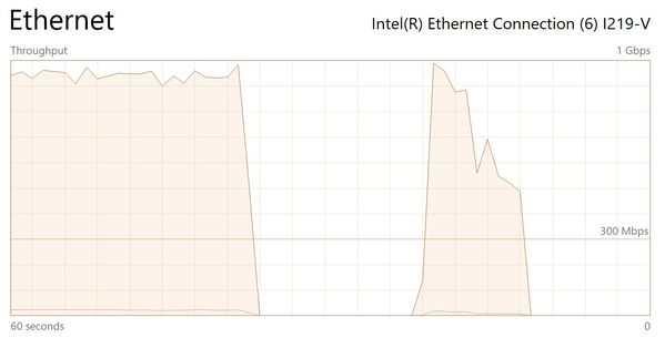

First image showing a local file transfer happening on the left (up around the 1Gbps level) and then followed by when a Speedtest takes place:
Samknows results:
Any idea how the internet speeds to the PC's can be improved?  The Speedtest briefly appears quite high but then plummets down to around 500Mbps (sometimes lower).  I've tried different browsers too.

    Notifications don't seem to be working lately, sorry for the delay in replying.  I'm just wondering how reliable even the Samknows test is (but it doesn't explain why the speed supposedly reaching the router is fine).
    I rebooted in Safe mode with networking and did a couple of tests and got about 940+ so thought it would be a case of finding the App/service that was slowing it down and stopping/uninstalling.  A reboot in normal mode then also gave me a nice quick speed (no change!) - but all subsequent ones slowed right down.  @carl_pearce ,  I had already tried setting the autotuning level (and tweaked almost every setting on the NIC) - but my speed more than halved when setting the autotuninglevel to disabled and I had to reset it to normal (for info, for others reading, you can check yours with netsh interface tcp show global from a cmd prompt).  I just did it again and my speed is around 120 on ethernet with it disabled
    @Cardiffman282 , I can get full 1Gbps speeds to the laptop from other devices (that all pass through the router) so my assumption is that the ports and cables are all good (all cat 6 or better).
    Randomly, I've just done five tests on the recommended site and got speeds the same as my first post - full speed to the router but about about 450 - 500 to the PC.  I've then done two tests on the speedtest App...  and got 850+ each time, which I'm fine with.. (interestingly, with the autotuninglevel set to disabled, even speedtest is around 120...)
