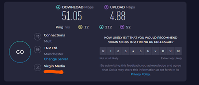

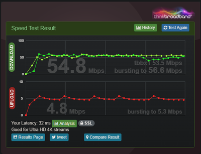

For the past 2-3 days, my internet has been very poor in terms of latency and download speed. My internet should be 120Mbps+ but now it's consistently outputting 40-60Mbps with high latency and the odd packet loss. I've restarted and rebooted the router but doesn't fix my problem and I've logged into the router and did a network diagnostic and nothing came up of concern. Is there works going on in my area or is it something else causing the issue.

 This is my speed test result using: www.speedtest.net and the other screenshot is from www.thinkbroadband.com/speedtest. I used two speed test sites to remove any discrepancies.

    The speed test results would be about right for an M50 service  ( 54 / 5 Mb/s )

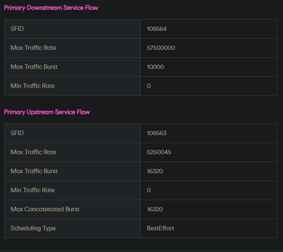

    Check the Configuration tab of the VM Hub to see what speed profile is loaded.
    Look for the Downstream and Upstream "Max traffic Rate".

    And for the downstream and upstream max traffic rate:
    That is an M50 profile.
    Restart the Hub 3 to see if there is an M125 profile to pick up for your account.
    You are looking for a Downstream Max Traffic Rate of 143,750,047 for the M125 profile.

  • Did a router restart and is still showing 57,500,000 on the downstream max rate. So that would indicate that my speeds have been downgraded from M125 to M50, right?
    That does appear to be the case.    Good luck with customer services.
  • Well it turns out that the account holder (not me) changed from M125 package to the essential plan, which explains the substantial dip in Mbps. With how bad my internet normally is with latency, this plan ain't it lol. Well, thanks for the help, much appreciated Client62.
