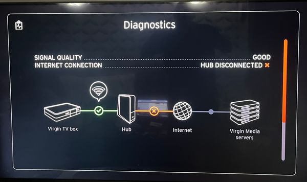

      Now my 360 box is having connection problems (CS9994) it’s hardwired to my router. Tried both hardwired & WiFi, same problem.
      Probably need someone to come out & check everything in house and outside.

      Try following the instructions suggested by the online help for /tv-error-codes/cs9994/start It should check for local fault and possibly show you how to check the connections, along with also possibly arranging a tech appointment.
