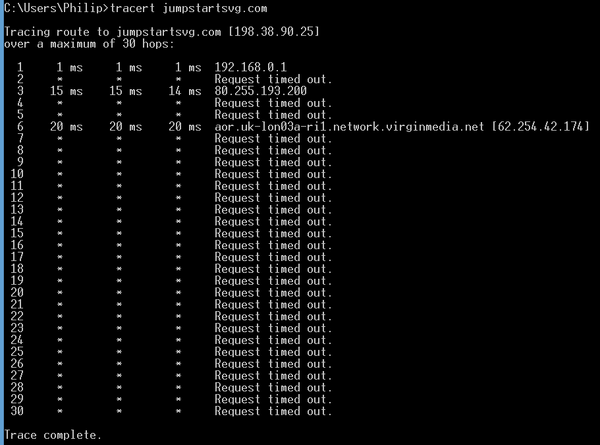

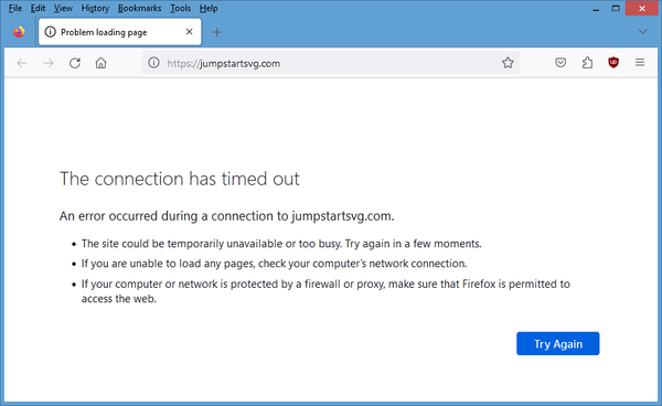

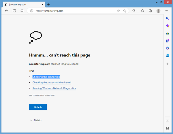

    Another regional routing fault on the VM Platform ?
    We are Colchester, Essex (VM Area 31) access fails for us in Firefox & in Edge.
    VM Area 31 is vast i.e. at least Chelmsford to Diss.
    We are being returned the correct IP so this is not a VM DNS
    issue related to Child Safe or Web Safe etc.
    The Trace Route also fails after the same hop as in the first post i.e. after :
    aor.uk-lon03a-ri1.network.virginmedia.net [62.254.42.174]
