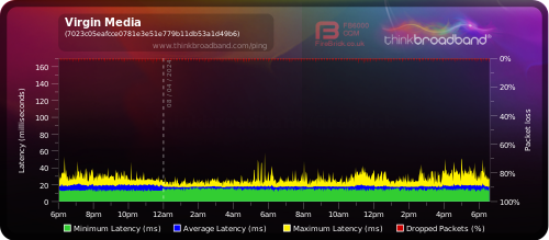

  • Here's my Broadband Quality Monitor from the last 24 hours or so, it looks normal to me? I genuinely think the issue is between my Router and Virgin Media themselves, I specifically think this due to everything being fine until there was maintenance in my area.
    Any idea what might be happening?
    Thank you very much once again.
    Here's my Broadband Quality Monitor from the last 24 hours or so, it looks normal to me so I genuinely think the issue is between my router and Virgin Media itself. I specifically think this because the issues only started after there was maintenance in my area, I have not changed anything about my setup.
    Do you know what might be happening?
