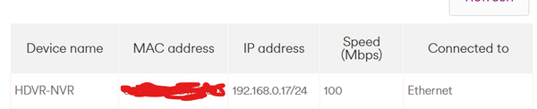

      Thanks I have had a look and somewhat found what has changed. I used to previously access the CCTV from my network on 192.168.0.20 however on the connected devices on the router that appears to have changed to 192.168.0.17, so I can view the CCTV again when connected to wifi both from a browser and mobile app.
      However if i drop to 5G (mobile data) on my app, it no longer allows a connection through to my router and to my CCTV. This used to work previously on mine and my partners phones but no longer does over mobile data.
      I have tried restarting the CCTV box, the VM Hub 3 and our phones, all to no avail. Including a reinstall of the app. It recognises the cameras on wifi, just not on data anymore. The cameras have not failed themselves.

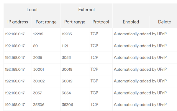

      I can see the CCTV box is connected on the connected devices too on the router. uPNP is enabled. In terms of IP reservations, I cannot see any restrictions on the firewall as such, not sure where to look for reservations?
      Port forwarding is also on these ports for that IP, which it has added by itself. I believe this is so that the CCTV box can talk to the external world via my router so that I should be able to access it via mobile data. The ports are a bit randomly added below but the main ones to my CCTV look covered.
      • legacy1's avatar
        legacy1
        looks odd that a CCTV needs so many ports...its best to disable UPnP and do it yourself.
        your WAN IP might have changed to connect to the CCTV by mobile data.
