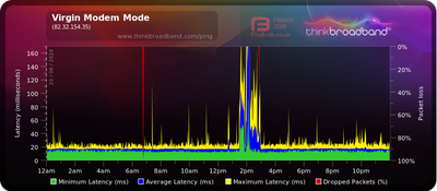

- fizzFibre optic
This was yesterday (reboot at 7am) -
its a bit random really out of nowhere and then is fine again. Router logs since that reboot as here
