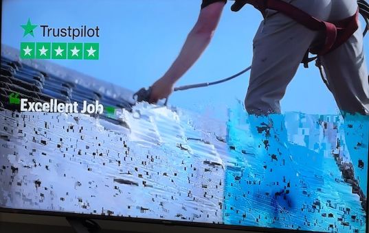

I have been on to the Virgin Media status checker for any issues and everything is coming back fine for Broadband & TV but for the last 12 hours our TV has done nothing but flicker. It's NOT The tv itself as it's ow under 1 year old and I can watch other things on it with no issues.

Below is an image of my TV problem,

    When you say this do you mean from other sources like DVD, Blu-ray or apps through the TV.
    Is it only live TV or apps and on-demand through the V6 box, if it's only live TV and limited to a few channels then it might just be a signal level that needs adjusting, if it is only a few channels if you say which ones they are they might all be on the same mux.
    If it is only the V6 box have you tried a different HDMI cable or reseating it.

    The 360 box is step back compared to the V6, so don't be in a rush to change that, I would try the things suggested to confirm if it is a signal fault or a fault with the box. If it's a signal fault then may need an engineer to fix cabling rather than the box. If they do want to change the box, I'd try and get a replacement V6 rather than a 360.

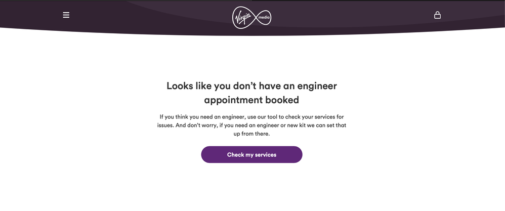

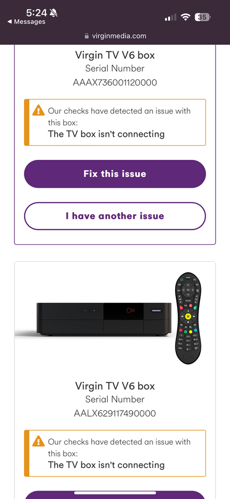

  • Virgin are a total joke.
    Tested the stuff and getting various faults from card issues on the box to box not being connected,
    Booked an appointment between 4pm and 7pm on Friday 5th  (Image attached)
    Just logged in and its now saying that I DO NOT have an appointment.
    Still got issues with TV skipping, Jumped and being fuzzy.
    Just on the phone to Virgin and they have told me they have cancelled the appointment and they will be out tomorrow.
    So I have taken 3 hours off work for no reason and I won't be home tomorrow, Virgin Have NOT told me this and virgin have not notified me of the change of appointment and if virgin did show top tomorrow I would be unaware and stung for a call out charge.
    After speaking with them they are telling me its now Monday between 4pm and 7pm and an engineer will be out.
