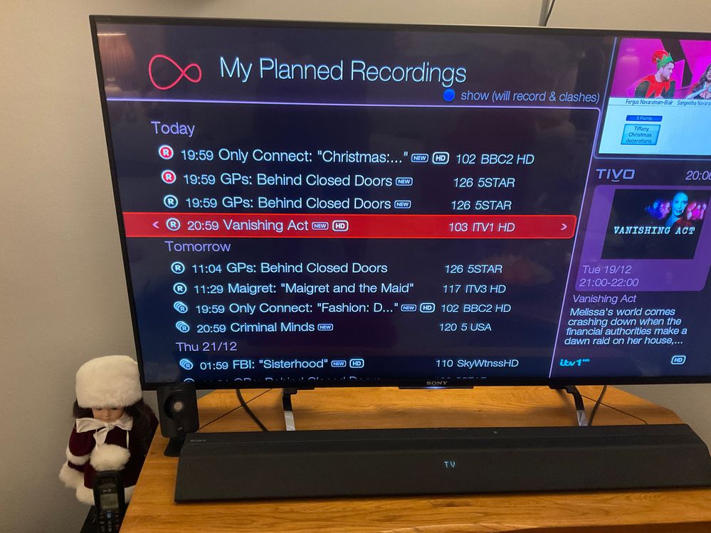

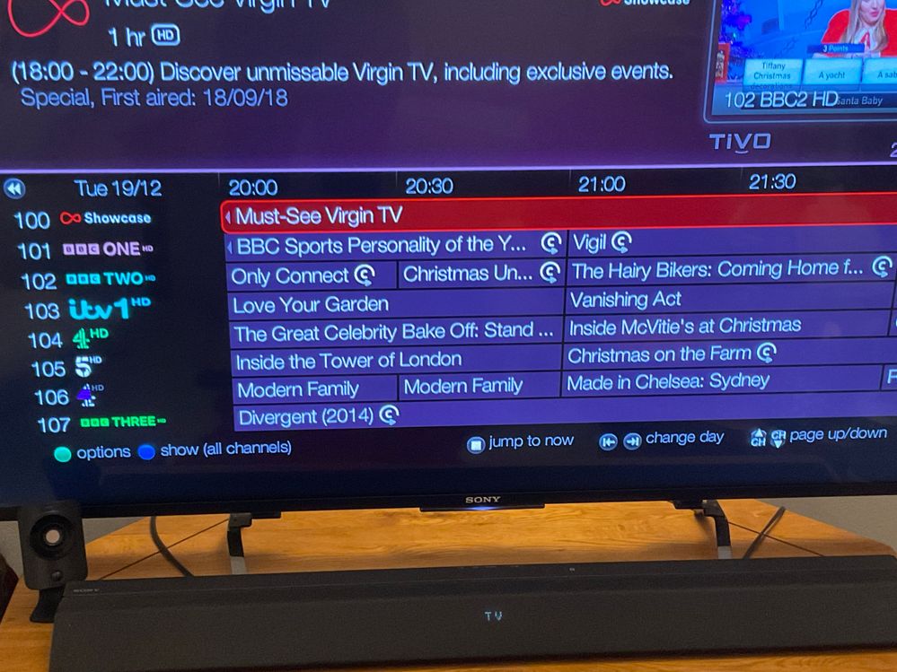

  • This one shows Vanishing Act not showing record symbolthis show it in Planned Recordings and above it shows that the same episode of GP’s being recorded having only pressed it once
  • Hi Daveydub612, You have reminded me that I had something similar happen sbout the same time, I did't notice an error code but I did follow the instructions on my TV to restart my system and it ahs been since then that I have had the problem.It is exactly the same as your photos where a series link or single time record has been accepted by the system recognised on My Planned Recordings but no icon on the guide indicating thast the process has completed. The choices actually record and will be available to play in My Shows. It seems to me to be a software/firmware problem. I live in East Cornwall/Plymouth area.
    Can anyone check with Virgin media to see if something went wrong on or around 16th December affecting our V6 installations

        If I choose record on a future programme in the guide the icon to indicate it has been accepted does not appear on the guiide, if I go to my planned recordings the one that I have chosen is there in the list and infact it does get recorded and I can watch it later.
        It is the same if I choose to make a series link, the icon is missing on the guide, it's in my planned recordings, it records and I can rfeplay it.
        But there is no way of looking at the guide to see what I have chosen to record, I have to go to my planned recordings to do this,
