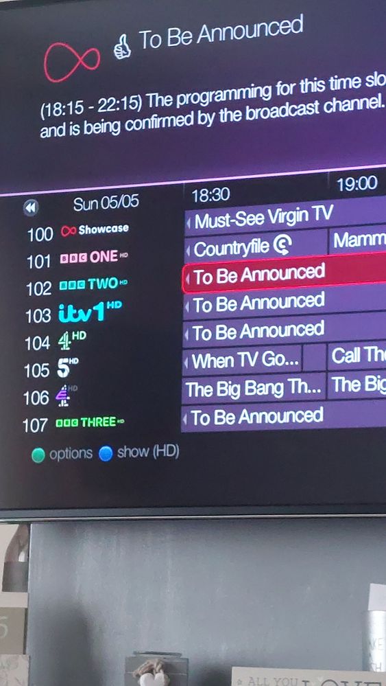

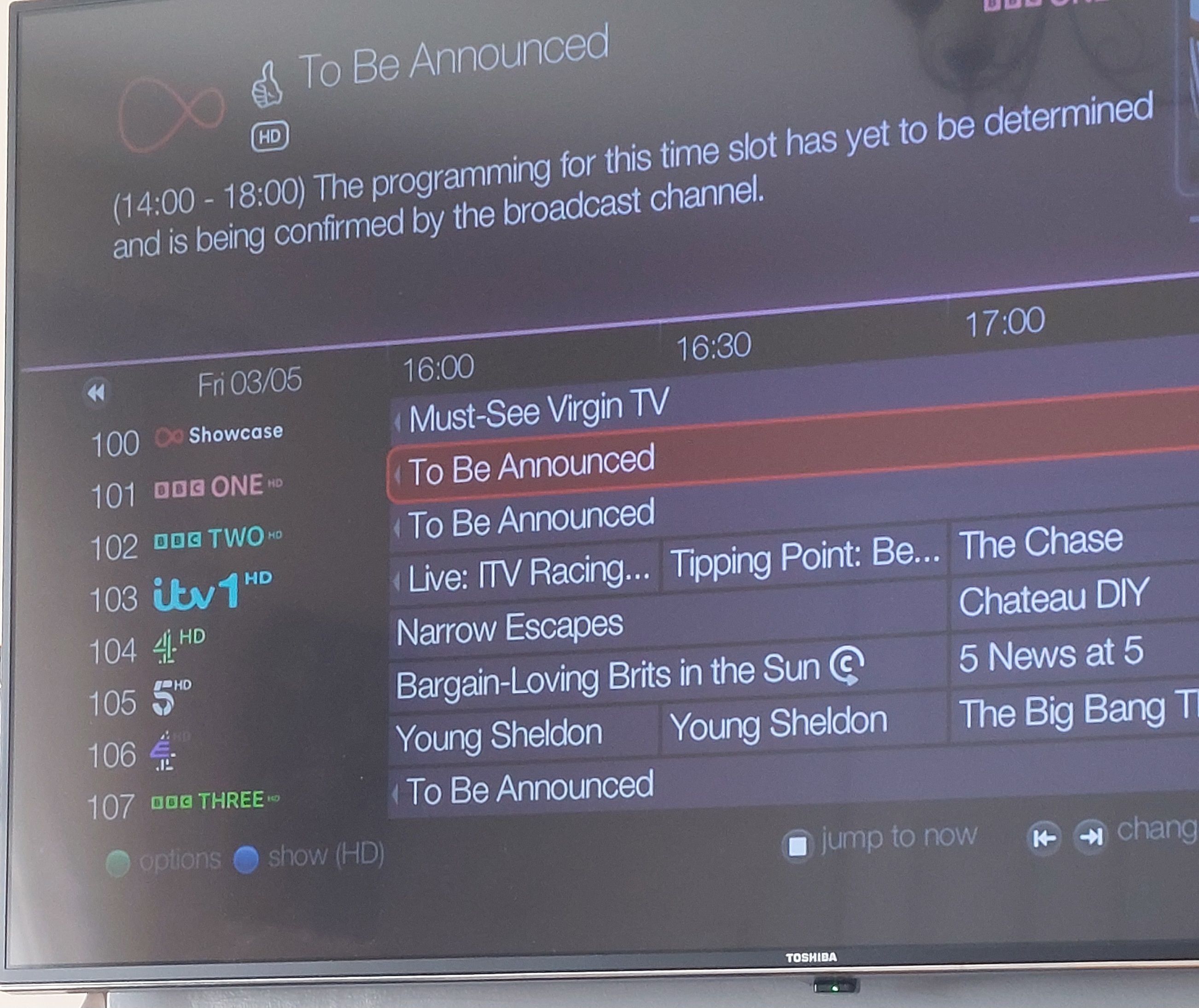

hi all, one of my 2 v6 boxes is constantly " showing  to be announced" on some maybe half a dozen channels" my other v6 "connected directly to my hub" is fine, I used some powerline adaptors to directly connect to my hub, but it made no difference. I think my v6 box is starting to fail, anyone else had similar problems?
In the attached photo, you can see that the channels are BBC, but I get the same on some Ch4 and Ch5 channels
Thanks in advance for any replies.

    Two specifics to check here..
    1: Does the box have a stable internet connection - using OnDemand or a streaming service is a good test of this.
    2: Are the regular EPG-calls-home working reliably? Follow Home > Help & Settings > Settings > Network. Check the LHS for regular successes or failures.
    It may be worth swapping your 2 x V6 around to check if the symptoms follow the box, or the cause remains with the network connection.

      I will try and swap the boxes if i can, it will not be easy as i am nearly 72 and disabled, I have netflix and amazon prime working over the wifi, they are both stable. As I said, I used some powerline adaptors to directly connect to my hub, but it made no difference. This was yesteday early evening.
  • I will have to try swapping the boxes but it wont be easy for me, don't get old mate.
