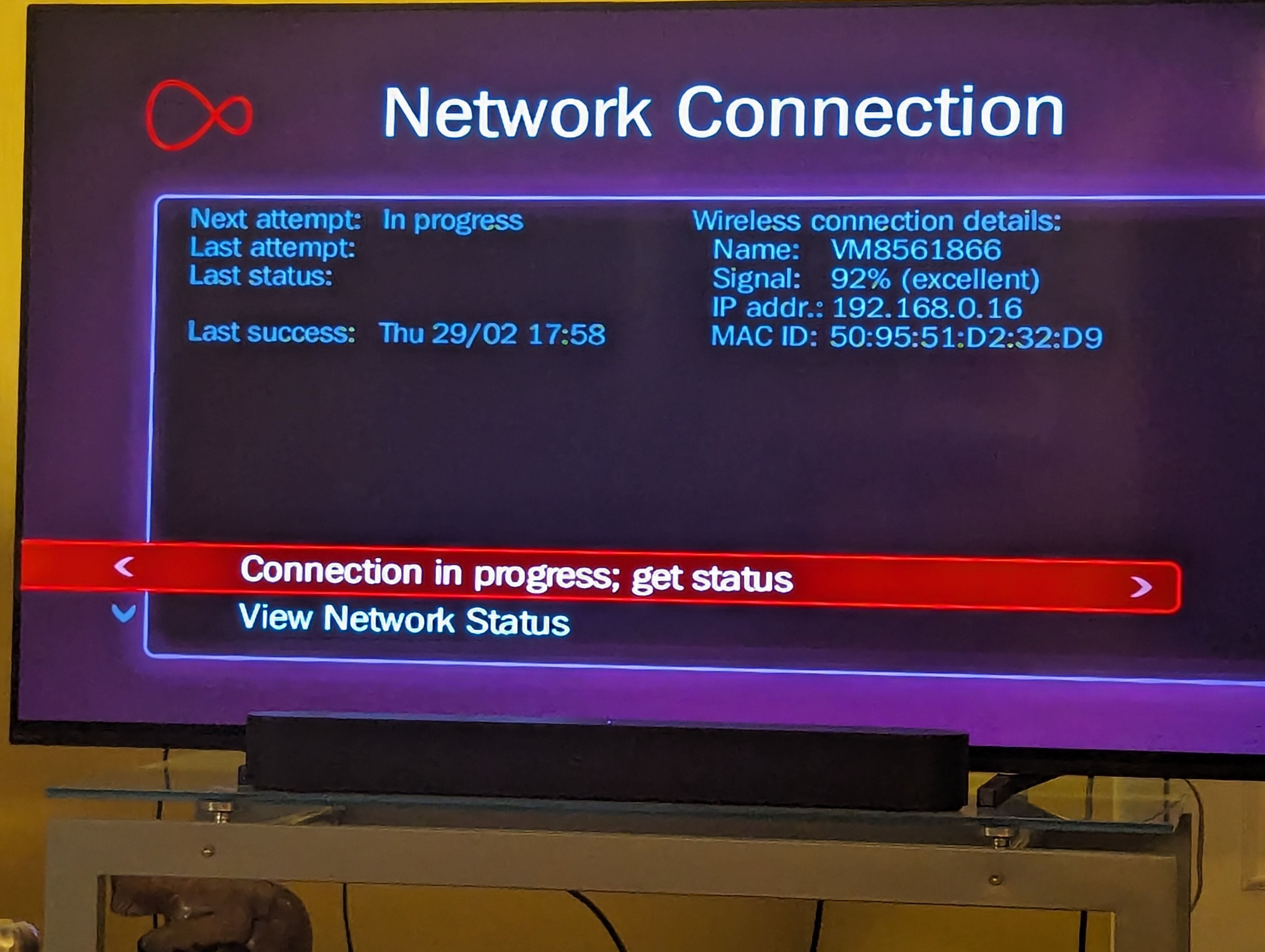

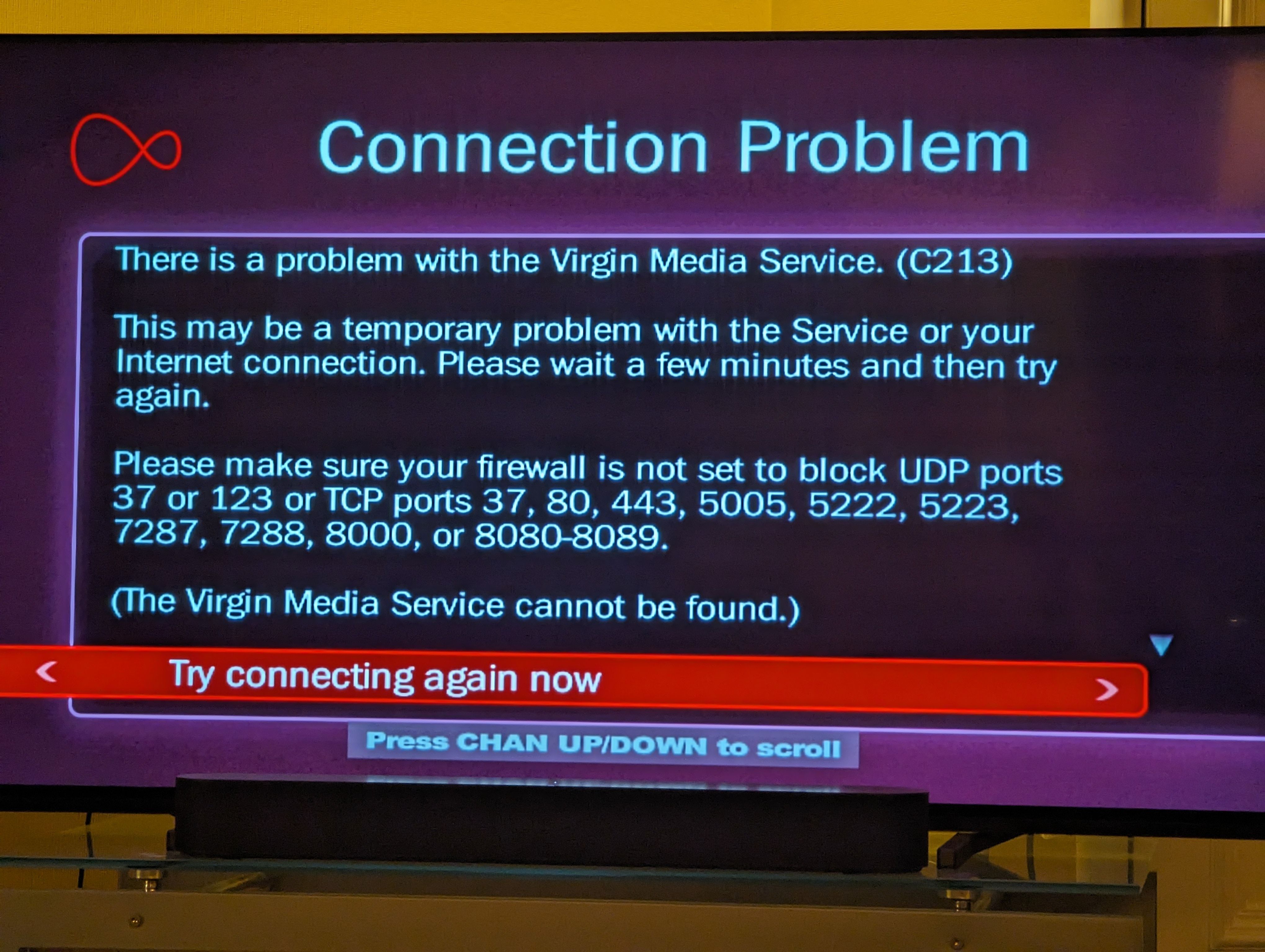

Trying to connect to the Virgin Media Service but it fails at the "negotiating" stage. WiFi signal is 100% (Excellent) and I've restarted the modem, router (external) and v6 box itself many times. Some channels only display "To be announced" in the programme guide, and my planned recordings are failing because of this. Nothing has changed on my side, I've had the same setup for years. Is this likely to be a VM issue?
Any help will be appreciated.

      I'm still having the same problem, all my programmes on the EPG are saying "To be announced" and the connection to VM Services fails at the negotiating stage. WiFi is strong, and I've no problem viewing content on catch-up.

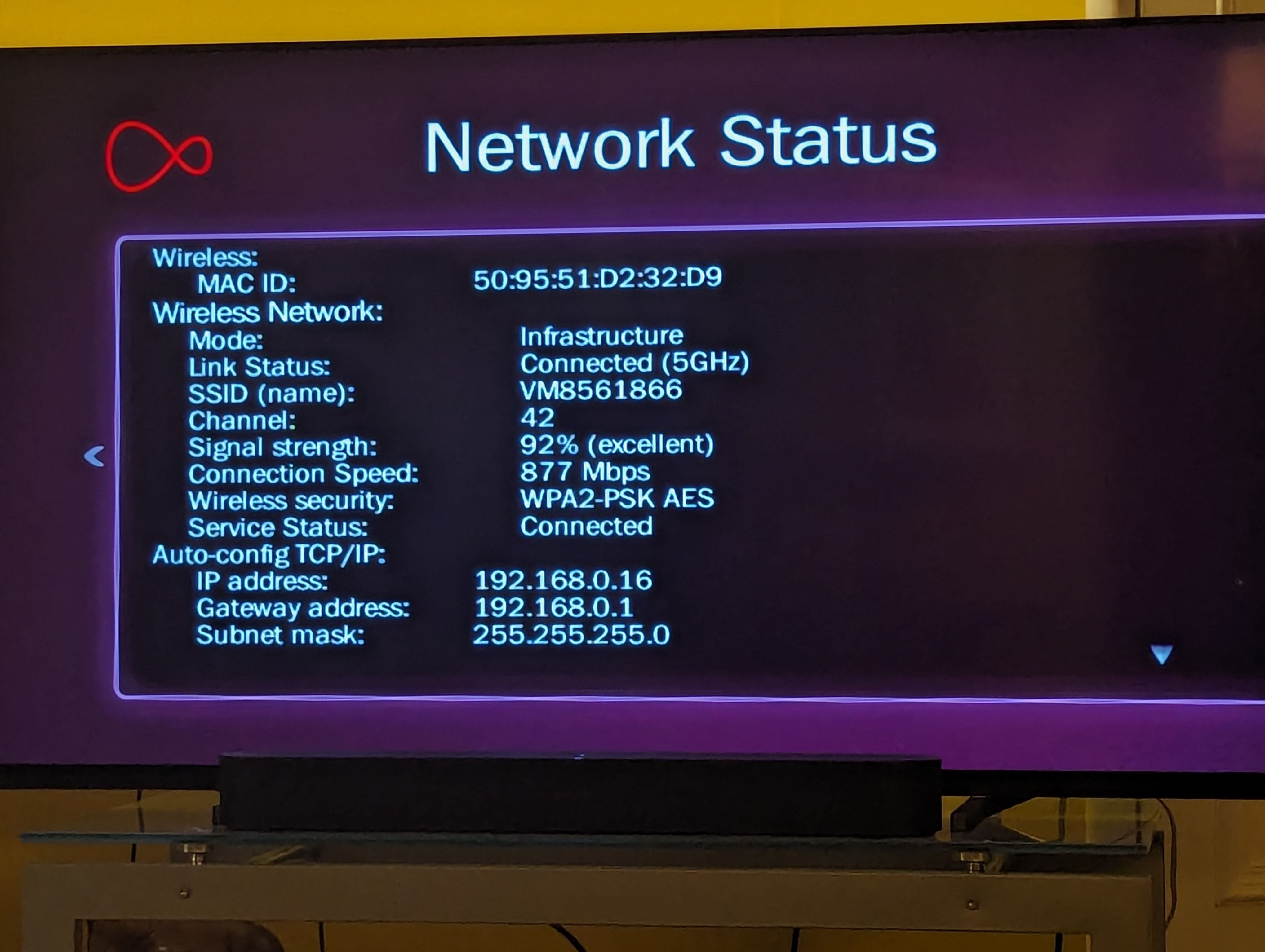

    If you loop your router out of this, put your Hub temporarily in router mode and connect directly... does this resolve?
    This will help prove the issue to your router config, or something else. The ability to view OnDemand programmes certainly eliminates the basics.

      Hi, thanks for that suggestion. I switched the hub back to router mode, disconnected my external router, then connected the V6 box wirelessly to the hub. Thai made no difference, I'm getting the same error (C213) when trying to connect to VM Services. Catch-up TV still working OK. Switched off the V6 box for 30 seconds and tried again, same error. Still awaiting contact from VM 2nd line support, but do you have anything else I can try?

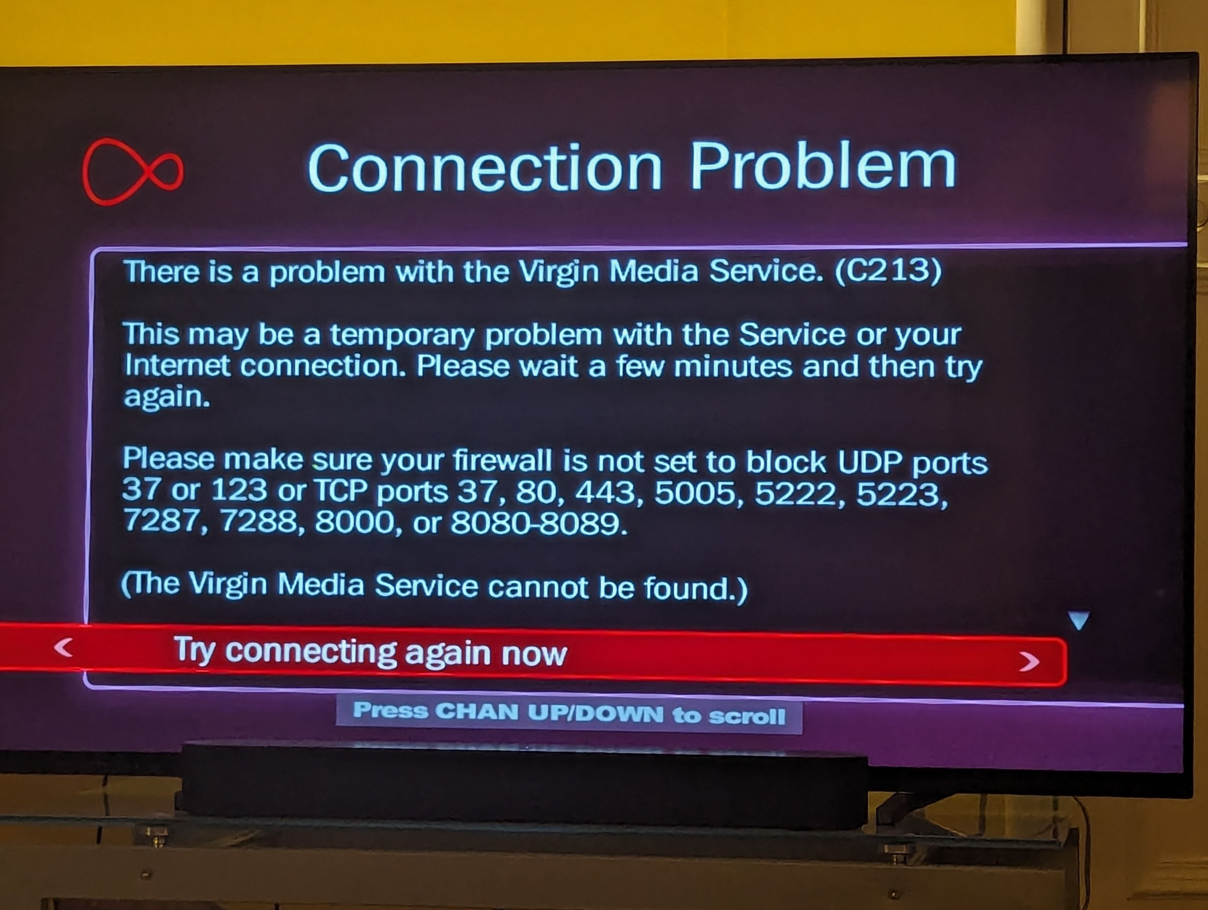

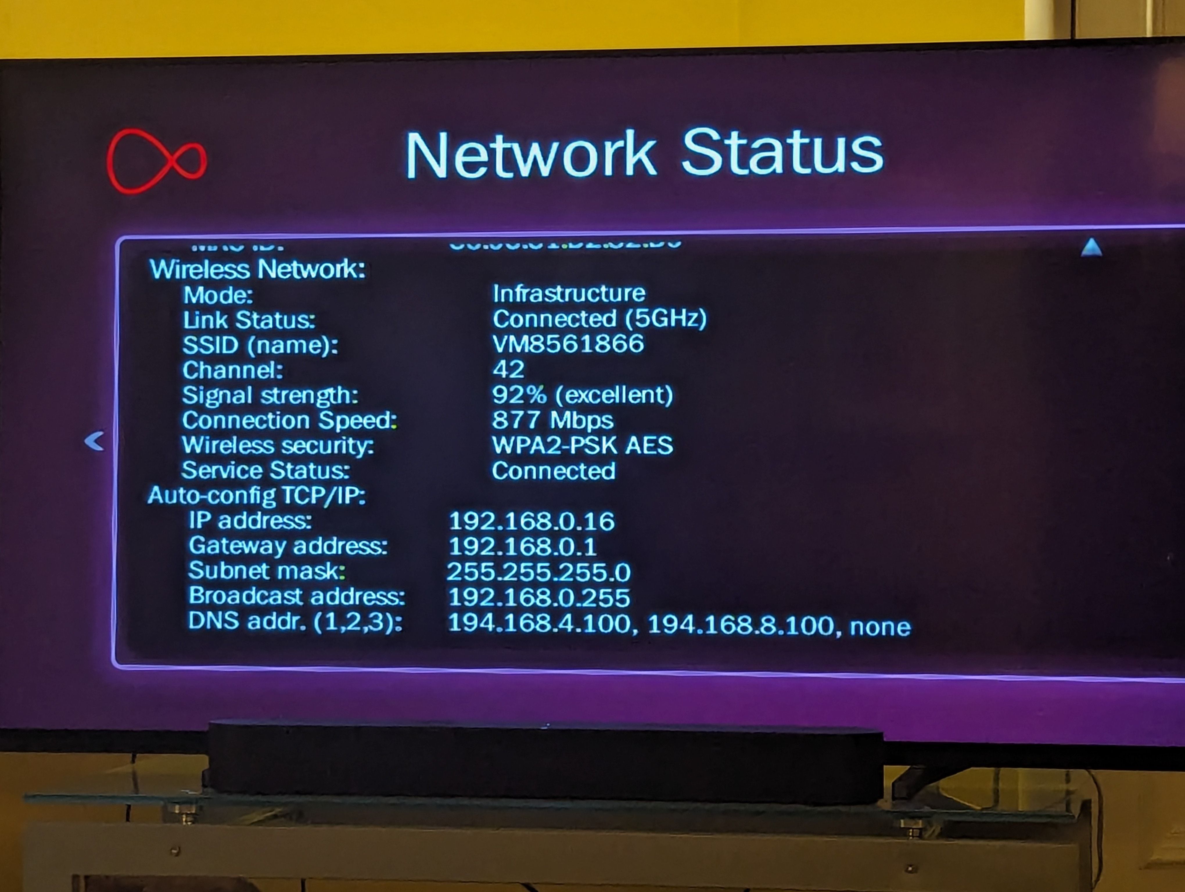

      Hi, I do agree with you about eliminating every possibility. To that end, I took your advice and plugged an ethernet cable into the V6 box, connecting directly to my router but got the same problem. I also tried using the Hub in router mode, connecting directly to the hub and looping out my Asus router. Again, same issue.
      Thanks again for your suggestions, you've been really helpful. However, I'm running out of options now and hope that Virgin can sort this out for me.

        Brief update - engineer from VM called and replaced the box, I now have a new 360 box and everything is working as expected.
