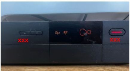

    It might be possible to get it up and running again by  turning off the 360 by the rocker switch on the back of the box;  then hold down both the standby/power button and the - (minus) button which is on the front of the box at the same time.
    Next turn on the 360 again whilst keeping hold of those buttons for a further 30 seconds. The box should reboot, the power button will turn blue, and it should reset and boot up normally as a 360.
    If the above doesn't work then use the same method again but this time substitute the minus button for the + (plus) button.
