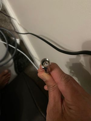

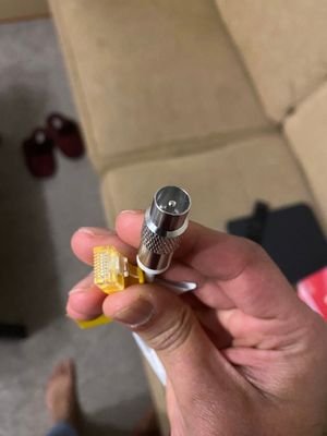

Hi, I am a new customer and recently received my self installation kit for my VM broadband & TV. The house i moved into already had a VM connection setup with a custom long cable that connects to the main VM wall output. This is a f type cable with both ends same, i.e with the copper wire centre.
Now the new kit i received had one cable that splits to form one for broadband and TV each. This isnt long enough for where I have my TV placed. If i buy a f-type f to f coupler to connect the custom cable to the new supplied one, will that work?? Want to know if that will affect signal loss or not?

  • Just to add to Rodger_Gooner's answer, in the picture that white coax cable looks thin (could just be a bit of an optical illusion but might not have the correct screening), and if you ask for a manned installation the signal levels will get checked properly.
    Also the less connection/ joints you have the better for reliability and I was also told on one training course that every connection you have causes a 10 db drop in signal, don't know how true that is and how noticeable it would be on 1 or 2 connections.
  • jpeg1's avatar
    jpeg1
    A straight connection between two cables shouldn't lose more than 1dB at these frequencies.
