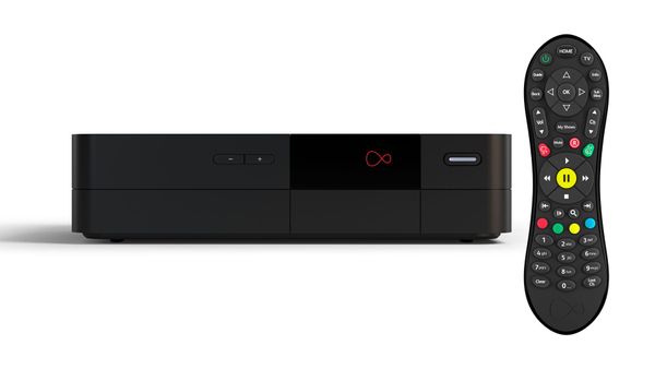

    Hi, many thanks. I’ve tried the above and has not worked. The M63 error still remains. I’ve been told two things from Virgin Media that the box has successfully been updated by the technical team, previously giving the serial and Mac numbers and another to say that they wasn’t able to send a signal hit to the box as they were prompted with an error at their end and this would need to be escalated. Below is the box that a have V6 with TiVo interface.

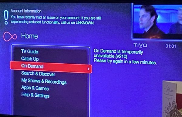

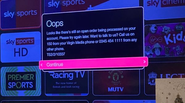

  • Dave's avatar
    Dave
    Hi, recently tried to upgrade to the Virgin 360 TV service. the current box that have is a V6. I’m now presented with the following error codes.
    Account Information
    You have recently had an issue on your account. If you are still experiencing reduced functionality, call us on UNKNOWN.
    On Demand is temporarily unavailable.(V210)
    Please try again in a few minutes.
    Service Activation Required
    Go to virginmedia.com/tvcode and enter your service number
    (XXXXXXXXXXXXXXX) to activate this UNKNOWN. The UNKNOWN will not work without an active service
    Before the upgrade the box would often fail recording’s
    Is there a straight forward fix without the need for a  technician visit.
    I’ve tried the following holding minus and power and plus and power during reboot and this has not worked.
    Many thanks.
