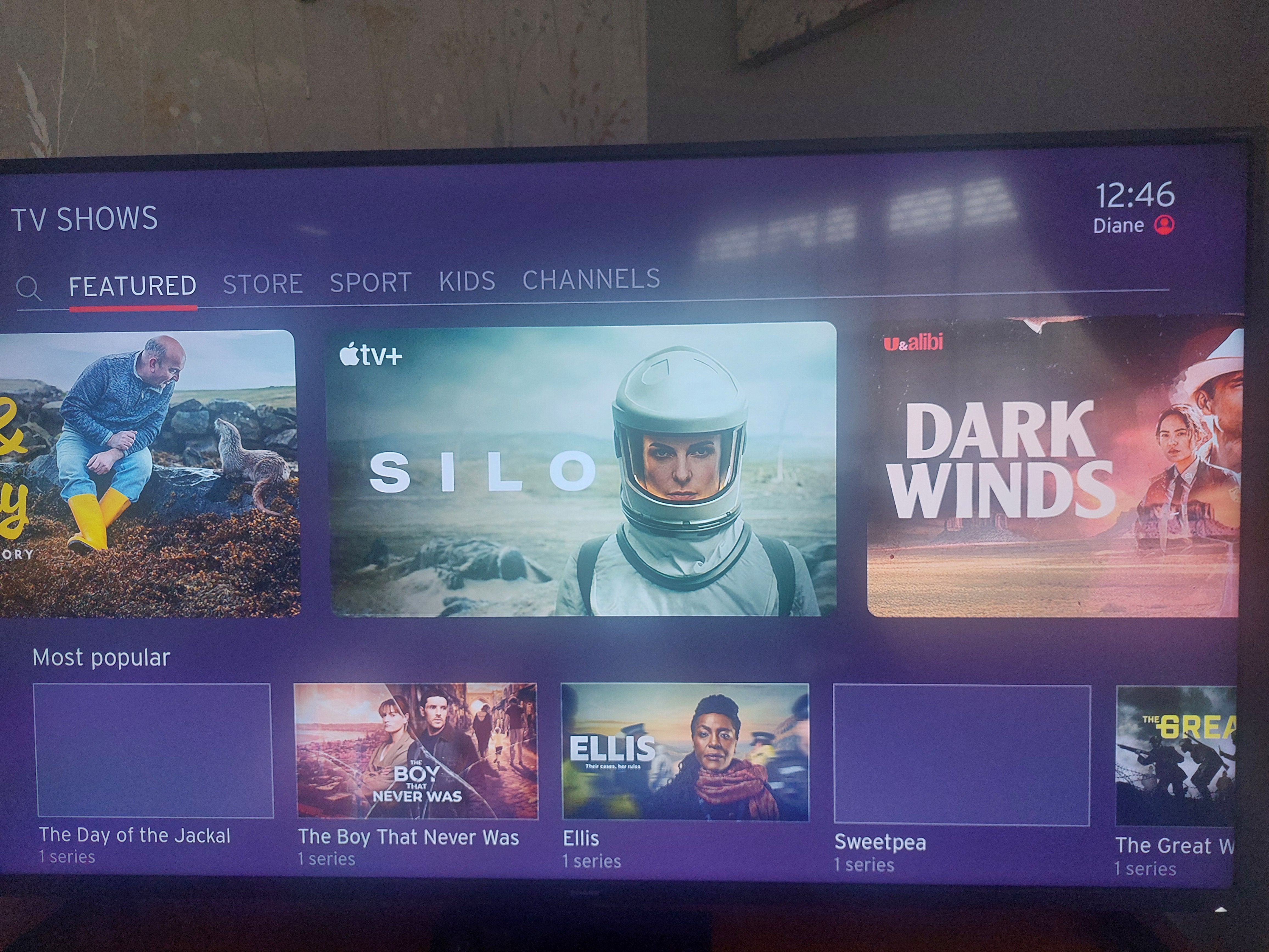

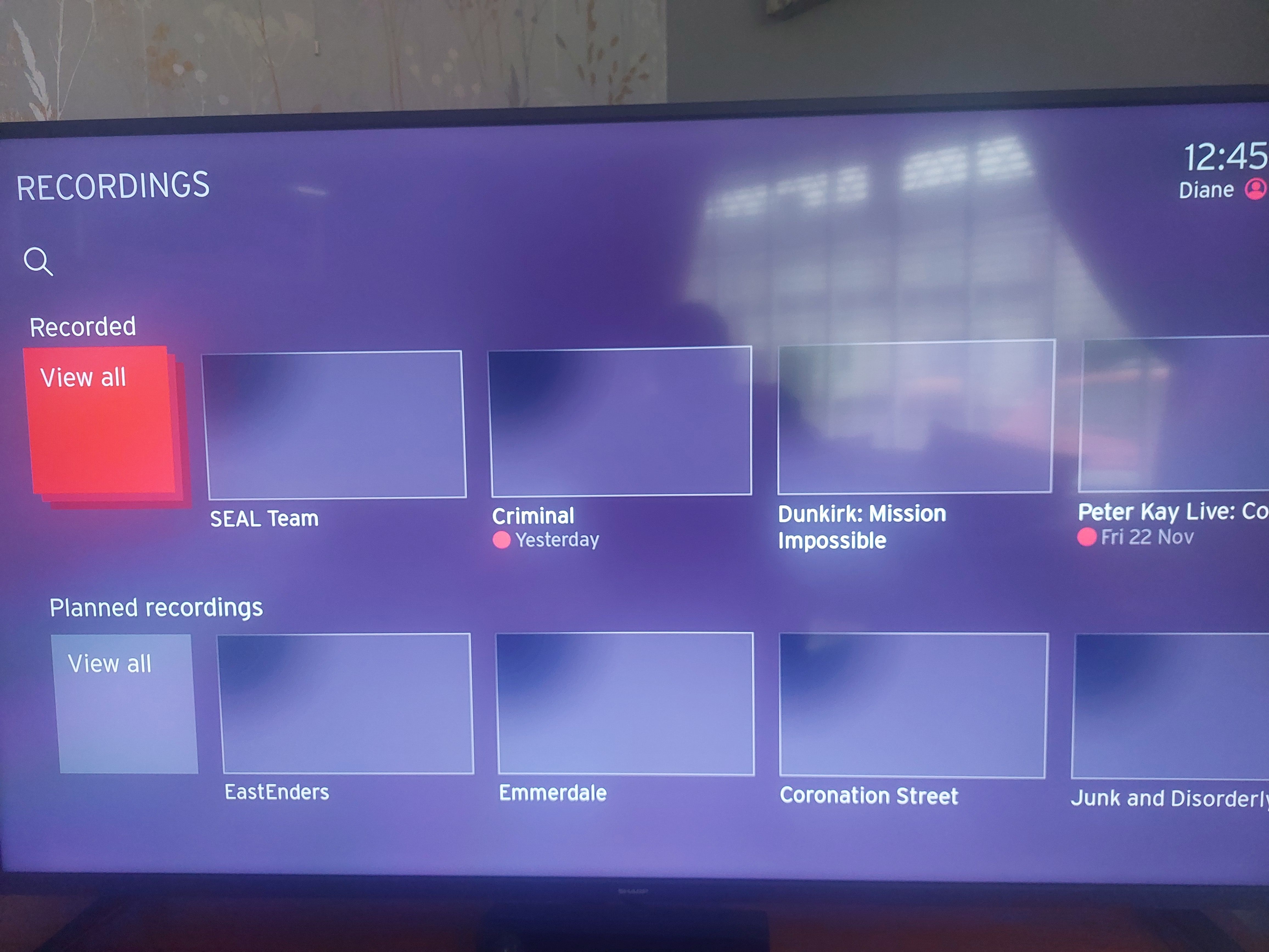

Missing icons?
 also get a something went wrong message when trying to play something from Amazon Prime?
Recently add Apple TV ?
Before this icons were there and no errors.
Hay turned it off and on again but si the same?
Any help appreciated
Keith

    Hi Keith,
    I notice the picture was taken when the 360 was using Diane's profile.  Do the onscreen graphics populate if you switch to the shared (default) profile?
    Generally the graphics don't populate when there is a loss of internet connection. This usually also shows up with a lot of TBA's (To be announced) showing in the EPG. This is usually fixed by either rebooting the hub, or 360 box.
    The error message (possibly CS9994) when trying to access/play something from Amazon prime was probably connected to a lack of internet connection
    Is anything showing under Settings> System > Diagnostics?

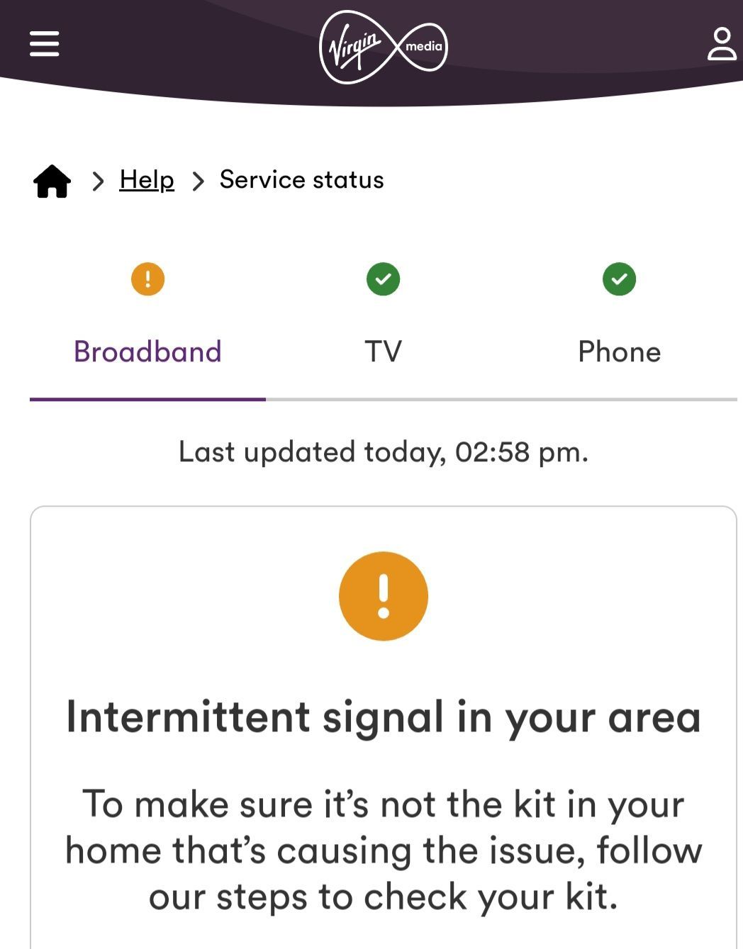

        Hi again keithsimmo
        You can always check for faults using the /check-services/ function. You can also a run a test on your equipment from there.
        If nothing is showing  you could also try the (preferred) automated Service Status number  0800 561 0061.  This often gives details of more local issues down to postcode level.

      • keithsimmo's avatar
        keithsimmo
        Update, spoken to "chat" support who have said it was a "provisioning issue " tried a "hit" which  apparently was "successful" and asked me to reboot.  Nothing has changed, still the same issues so have escalated to next level support who will try some remote fixes, estimated fix time 5 days!!
