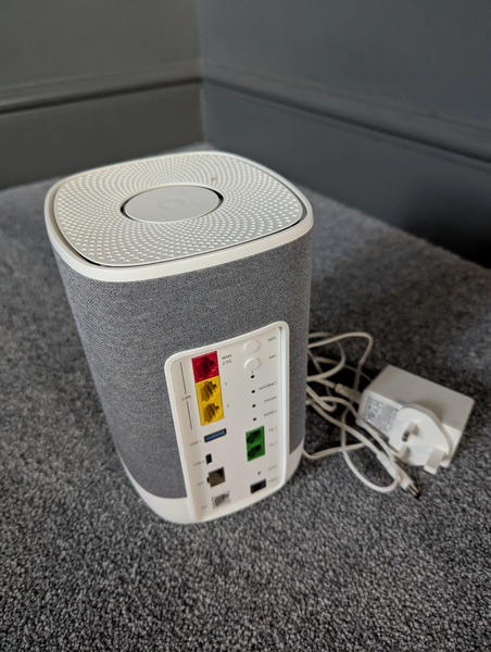

I have issues with my WiFi speeds, there's another really long post about this on here, but I can't get any help that improves my issue.
My question is could I buy a 2nd hand Vodafone 6e router and put my hub 5 in modem mode and use it?
Will it work?
My WiFi is severely congested due to neighbour having lots and lots of cameras, access points etc.
Anyone have any experience using the Vodafone 6e router in this way with Virgin? I'm desperate, I've tried everything else and had multiple engineers visit
