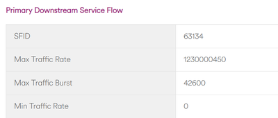

    Check the conf settings on the Hub. It will show what speed has been provisioned.
    It's Configuration tab - Primary Downstream Service Flow - Max Traffic Rate.

  • Thanks for the reply, I've checked and these are my readings here:
    Is this the correct number you'd expect to see for gig1 fibre?
    Yes, that's correct for 1Gb.  Try the VM Hub firmware speed test www.samknows.com/realspeed
