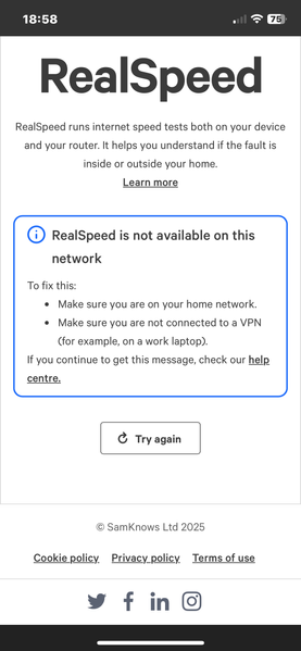

    Run a direct wired speed test at www.samknows.com/realspeed
    Post the results please.
    • Tomo72's avatar
      Tomo72
      Superfast
      This is all I get below. Hub3 is in modem mode with a tp-link router attached, it’s  been like this for years and I’ve always had 350+

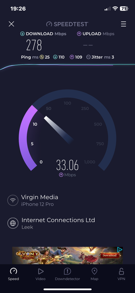

  • Interesting, so I’m still getting the same error on SamKnows in router mode but this speed on speedtest.net wireless

        So your wifi speed looks ok for that router what wired device do you have?
