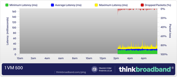

Hi,
I've recently came back to VM (October) and my connection has not been quite right from the off.
Intermittent packet loss which is now more frequent. I've reset the hub a couple of times, and it resolves for a day or so, then back to its old self. I've noticed since the last reset (this morning) that on the router log there seems to be a constant stream of upstream profile changes (Around once every 5 minutes).
I've set up a BQM again this afternoon and here is the graph so far -
Hopefully one of the VM forum techs will see this and hopefully shed some light or help get it resolved please.
I will post my line stats in the next post.

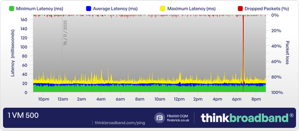

    Just for information I've now updated the BQM for the last 24 hours. The large packet loss on the graph was me rebooting the Hub 5 again just on the slim hope it might help resolve the issue!
    I did have a look at the connection in the brown box and it did look badly corroded to me, but it was dark and I couldn't get a decent picture, so will have to wait until I can get a picture in daylight.

    Anyway I've had a look at the connection in the brown box and to me it looks really corroded but it was too dark when I got in from work to take a decent photo, so will try again in better light.
