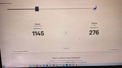

I seem to have a problem similar to others recently. I am on Gig1 but the download speed at my computer is around 400 Mbps. An engineer came out today and tested the system and all was OK at the hub with over 1 Gb so the problem is on my side. I have the hub in modem mode connected to an AmpliFi router. I have replaced the cat5e cable with a new cat6 which made no difference. My ethernet card is a Killer E2200 Gigabit controller and the driver is up to date. I ran the Samknows/realspeed test and it shows this:
In case the image does not transfer properly, the speed at the router is 1145 and at the computer, 276.

    I see that you must be running in router mode on the hub. If you are using your own router why is this? As you are in router mode plug you machine directly into the hub and rerun the speed test. Also what hub is it?

      Thanks Tudor. The hub is a 5 and it is as you say, in router mode. The reason is that the WiFi was so poor that I use an AmpliFi as a WiFi router and it works very well. I plugged the desktop directly into the hub expecting 1 Gig but no, I only got 410 Mbps. I think this kind of confirms that it is my computer causing the problem as the engineer got 1Gig when he tested it on his machine and Samknows also shows this. What now?

    To test, bypass the AmpliFi and connect the pc directly to the Hub, if you are getting gigabit line speed (about 930-940Mbps) that would point to a setting in Amplifi. If you are still seeing around 276, then look at the QoS or "gaming traffic prioritise" type setting in the NIC driver, if any of it is enabled, try disabling.

      Stefcolosi thanks for the help. I have looked at my network card and by searching found out that it could be limited to 100Mbps but when I checked on 'Speed and Duplex' in the advanced properties it was set to 'Auto Negotiation' which is what people said it should be. As you can see from my other replies the hub is downloading at 1 Gig but that speed is not getting through to my computer even when plugged directly into it.

        So for testing, PC is directly connected to the hub5 (and the other ports are empty), amplifi is off, and hub5 is in router mode. And is PC wifi is disabled? is the hub5 wifi disabled? And the pc doesn't hit line speed. Check every part of the chain. I would test a different computer or laptop also connected to the hub5 via 1gbe, If that does get line speed then there may be an issue with either the NIC or your pc as you have checked the ethernet cable. If you can use a different NIC, either a pci card or the onboard motherboard ethernet port (i'm not sure whether your E2200 is a card or built into the mobo), try that. if that does get line speed then look at reinstalling NIC drivers for the E2200, failing that there may be a physical issue with the it.
        PS i am confused as to whether you are in Router mode or Modem mode on the hub 5 when you normally run it with the amplifi. your post says its in modem mode, but then you have a realspeed test which means its in router mode. if you are using your own router you should put the hub5 in modem mode. if its in router mode + the Amplifi you are double NATed which will be an issue.
