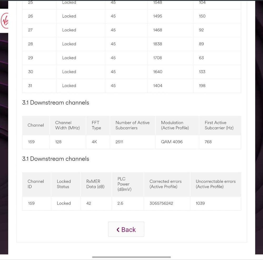

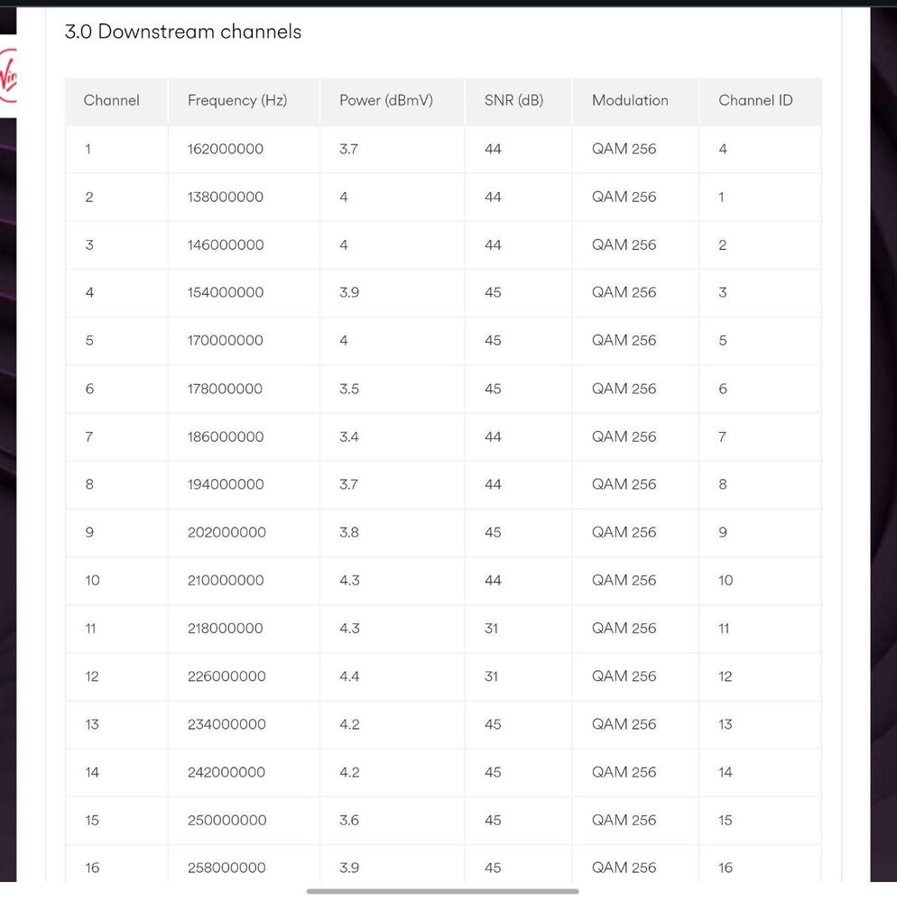

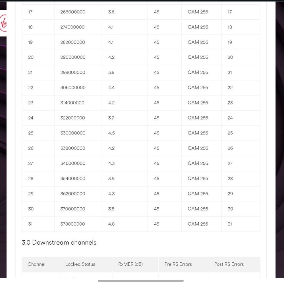

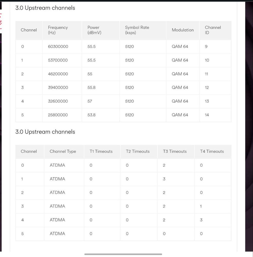

    Stumbled across this thread just now, crazy to see your live graph is still absolutely all over the place during peak times 2 years later. I have just moved in to a new flat where VM is the only viable option and was worried about my BQM but after having a look around the forums I don't think I can complain too much ๐Ÿ˜‚ This is before I install my BE98 and put the Hub 5 where it belongs, in modem mode too. (ignore the packet loss it was a restart): My Broadband Ping - Bookers
    Still hurts coming from a full FTTP connection though: My Broadband Ping - Home
    • Matthew_ML's avatar
      Matthew_ML
      Hey Sauce245, thank you for reaching out and I am sorry to hear this.
      I can see you have spoken to the team since this post, did they manage to help at all?
      • Sauce245's avatar
        Sauce245
        Hey Matt,
        I spoke to the team regarding something else, it was to do with the activation date being wrong, that has been fixed thanks.
        I have another sort of issue though if you wouldn't mind having a look please? Basically, I moved to a new flat with Gig1 and the flat has VM ports in 3 rooms. Looks like the other ports are fed by coax from the master port, I guess they were used for VM TV by the previous tenant. I have plugged in the cable feeding the bedroom port from the master port, and plugged the router in to the port in the bedroom, it works in terms of speed (the upload seems to struggle to get above 85Mb though), but I keep seeing random packet loss and noise on the BQM, especially when running speed tests.
        Would you mind taking a look at my config to see if using this secondary port in the bedroom is OK? I haven't actually moved in fully to the flat yet so haven't been able to properly test it with online games or anything like that.
        If not is it possible to get the master port moved? I really need the wired connection.
        Thanks in advance. My Broadband Ping
        P.S hopefully I didn't include any sensitive info in the screenshots.
