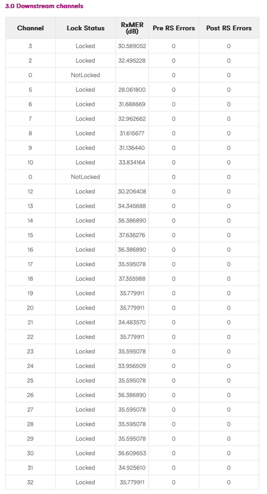

I hope you can help, I am looking to move my broadband router from downstair into one of the upstairs bedrooms as I have new TPLink wifi access points.

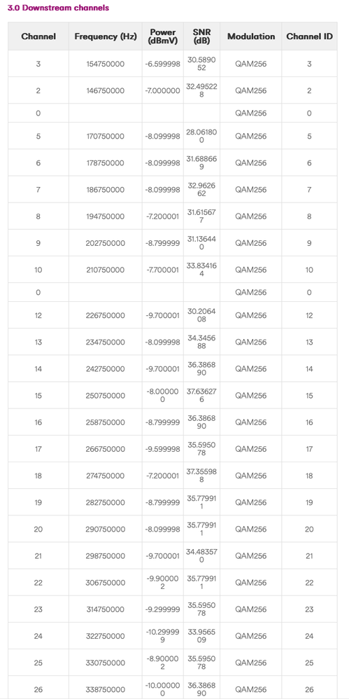

I have an existing coax cable that runs on the outside of the house and I have managed to connect the router with a a coax extension. All seems to be working except I have noticed my speeds are slightly down and I can see on the router page that some of the downstream channels are not locked.
Does anyone have any ideas on how I can get this resolved?

    There is a fault with the outside cable, or your own extension, or both.
    This is why you should not make changes like this. You may also be causing problems for neighbours connected to the same cabinet.
    Call CS and book a technician visit who will put this right for just £25.

    1 ) Not using triple shielded coaxial, which is essential for cable services as cable meant for TV aerials & satellite will allow noise to leak onto the local network. If this gets as far as the cabinet amplifier all your neighbours will also suffer technical issues as a result.
    2) Changing the length of cable also changes the signal level balance. This can only be addressed by opening the street cabinet to make the necessary adjustments to your drop line.
