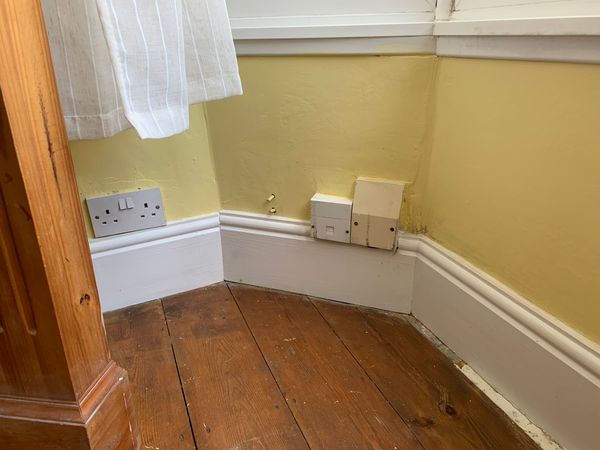

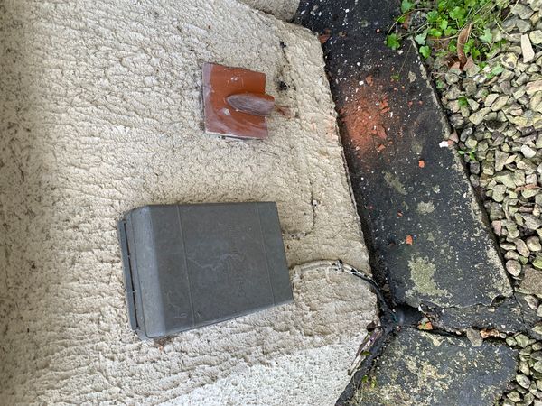

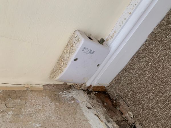

Removing old cabling and boxes
Hi, I am getting the render removed from my house and need to remove all the old cabling. This cabling is all redundant and has been cut off inside my house (there is no internet or phone line). In the future I’ll be getting fibre optic which I imagine will be a different cable. How do I get this removed?

    All those internal boxes and the "brick buster" on the outside you can remove as there are no cables.  As for the grey Omnibox, VM "should" really send an engineer to put a 75 Ohm termination cap on the end of the cable.  Open cables like these could introduce noise to the entire street cabinet and those connected to same.

      as a non customer VM are very unlikely to send anyone out - give them a few days to comment and if as usual nothing happens then take wire cutters to the external cable and remove the omnibox - you have asked - if removing it causes network problems which is unlikely then thats not your responsibillity
    I had always thought cable ends needed to be terminated?  Although I suppose the cable might be disconnected in the street cab.
