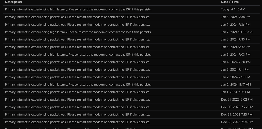

Secondly, I am alerted almost daily by my Unifi router that there is high latency / packet loss. Is this something Virgin can help diagnose please? What's the best step forward here. Thank you

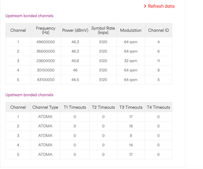

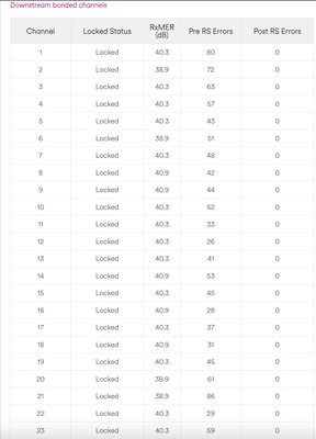

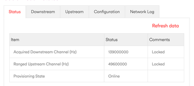

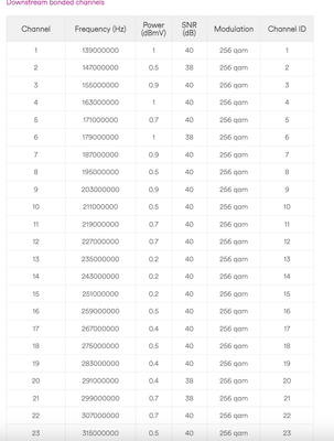

    Also Post the power levels, Pre and PostRS errors and network log from the Hub.

    Tried the service fault number. It recognized my mobile device but it seems still associated with my previous postcode (I transferred my service 4 months ago!!!), and I don't have a virgin landline to enter. Nonetheless, i've been receiving these packet loss / latency alerts on average once or twice a day since I've been connected here.
    Have set up the monitor - doesn't look too bad actually. This is for the last 24 hours. Note, my Unifi console most recently reported packet loss at Jan 9, 2024 9:40 PM

     Re the power levels, Pre and PostRS errors and network log from the Hub, hopefully this is what you're after:
    EDIT: I'm not able to upload my error log, but it just consists of roughly once every other day of the following:
    DHCP RENEW WARNING - Field invalid in response v2
    No Ranging Response received - T3 time-out
    Many thanks for your help
