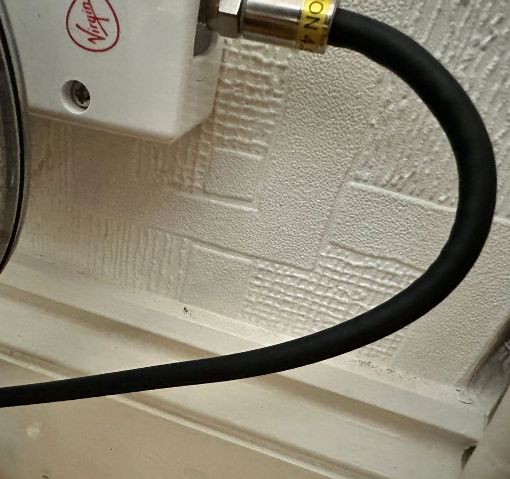

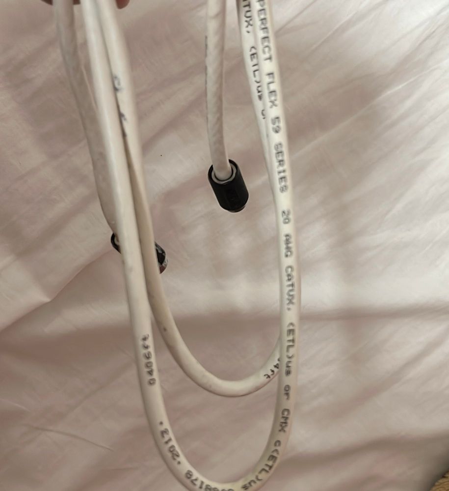

Main question here is the internal cable that comes from the wall to the super Hub has now been changed from rg59 to RG6 and I have bent it a little bit without even thinking
I just want to know if this is okay also

Black cable is new RGB6, old is white RG59. Length is 2metres to hub.
