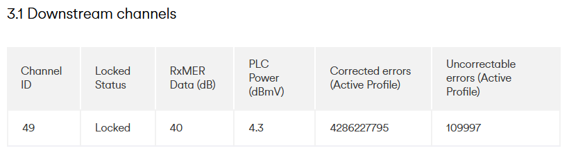

  • daveeeh's avatar
    daveeeh
    Hello,
    It's not really about the download speed, its about the quality, the time its taking to do things, lag in games, lag loading videos or even websites. I have been speaking to someone by PM but feel like I am going around in circles now.
    So on the 3.0 channels there is no uncorrectable errors
    But I tried to explain to the person via PM about uncorrectable errors on the 3.1 channel and they have so far managed to not even mention them.
    These are the uncorrectable errors on the 3.1 channel, going up by about 15,000 - 20,000 per day
    That doesn't seem right to me. Should it be like that?

    • daveeeh's avatar
      daveeeh
      And today :
      3993388380 correctable errors
      33784 uncorrectable errors
      In the space of 24 hours??

  • daveeeh's avatar
    daveeeh
    Thank you, though I have asked in PM over 6 times now regarding uncorrectable errors and what is an acceptable rate and have been blanked. Received no reply at all to that question.
    3.0 has no post-rs errors
    3.1 now has 75000 and counting and its only been up a couple of days
  • daveeeh's avatar
    daveeeh
    Engineer came out, replaced an isolator and replaced the line from the box inside the property to the router. Also going to get whatever team it is to monitor the box in the street for noise.
    Uncorrectable errors after a few days now sitting at just 11. Far better than the thousands I was getting per day and so far no issues
  • daveeeh's avatar
    daveeeh
    Final update. Seems a lot better now, post-rs errors now stand at 13 which for over a week of uptime is perfectly accetpable as considering last time by now it was around 100000.
    Websites seem better in general. Think the new line they fitted did the job
