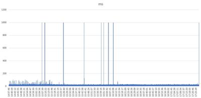

My connection is getting annoying time-outs. For several years my connection was stable, but since 4-6 weeks the connection cuts off for 5-60 seconds every 5-90 minutes. Quite random, as you can see.
  • Hub 3
  • I did all sorts of reboots, resets, cable checks, modem placements and anything I can think of.
  • Happens on all devices at the same time.

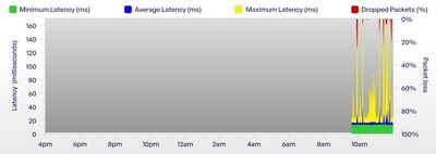

It goes on like that. The graph doesn't really paint the full picture. I don't notice the yellow spikes, but the red spikes should be 100%.
This here is more accurate. Fine most of the time, but then random time-out.
