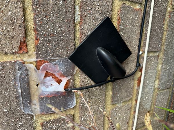

Outside cable cover
The small black cable cover has come unstuck.  I’ve had a go myself but it’s not flat any more.

  • Here it is.  I think I’ll get it flat with heat, and I have suitable adhesives.
    It’s more frustration at not being able to speak to/communicate with someone in a company that deals with communication!
  • Hey RoboFramer, thank you for reaching out and a warm welcome to the community.
    Please can you just attach a photo of what you mean so we can check this out please?
  • I thought I’d posted thus already!
    I think I can sort it myself.  It’s more frustration at not being able to  easily communicate with a company that deals in communication!

  • goslow's avatar
    goslow
    The only thing a VM tech will do is splodge it back on again with another blob of silicone. You will probably do a better job of it yourself.
    The hole is well-sealed with silicone. The black cover is mostly decorative. For a permanent fix, try some better sealant/adhesive and put a screw in the top of the cover plate to stop it falling off again.
  • I’ve stuck it back best as but it’s still not flat against the wall, I can seal the gaps I suppose and then put a plant in front of it but I’d rather have a nice new flat one!
      Did you remove the old silicone from the brickwork before re-applying new silicone?  As suggested by goslow​ , I'd also use a couple of screws at the top, into the cement, to make a better job.
