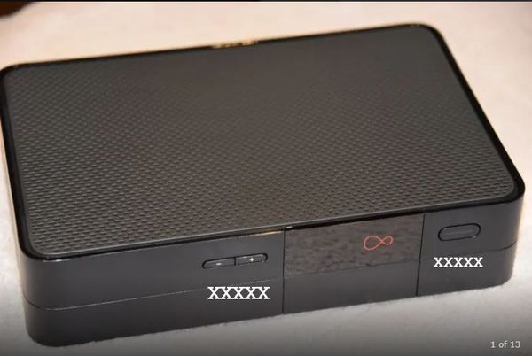

    Sorry to see you are having problems with the migration to TV360.
    Which method did you use to reset the V6 box?
    There are a couple of things you can try to complete the process.
    Try turning off the V6 by the switch on the back of the box;  then on the front of the box  hold down both the standby/power button and the - (minus) button at the same time. Then turn on the box again whilst keeping hold of those buttons for a further 30 seconds.
    If the standby/power button and the -  button workaround doesn't solve it then try using the standby/power button and the + (plus) button at the same time instead.
    You could also try the three fingered salute, which is switch off on the back of the box;  then on the front hold down the plus, minus and standby/power buttons at the same time, and switch on again whilst keeping all three buttons pressed down.  When it restarts you might see a message it can't acquire the channels. If so press OK and let it restart again.
    Some people with this error have also managed to perform the update by either removing the box from the mains for five minutes and trying again, or by deleting a few recordings to make more space and then trying again.
    If you do manage to migrate the V6 to become a 360 using the above process then make sure you remove the plastic tab from the back of the 360 remote so the batteries can touch the metal contacts in the remote control.  It sometimes helps to have spare batteries as well in case those in the remote are not new or fully powered.
