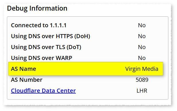

    Web Safe requires the use of Virgin Media DNS to work. To check go to https://1.1.1.1/help, from the device experiencing issues, and confirm AS Name result reports Virgin Media, as highlighted below:
    If AS Name is not reported as Virgin Media then either DNS has been manually set on device or, if using Hub in modem mode, third-party router is not set to use Virgin Media's DNS (194.168.4.100, 194.168.8.100).
