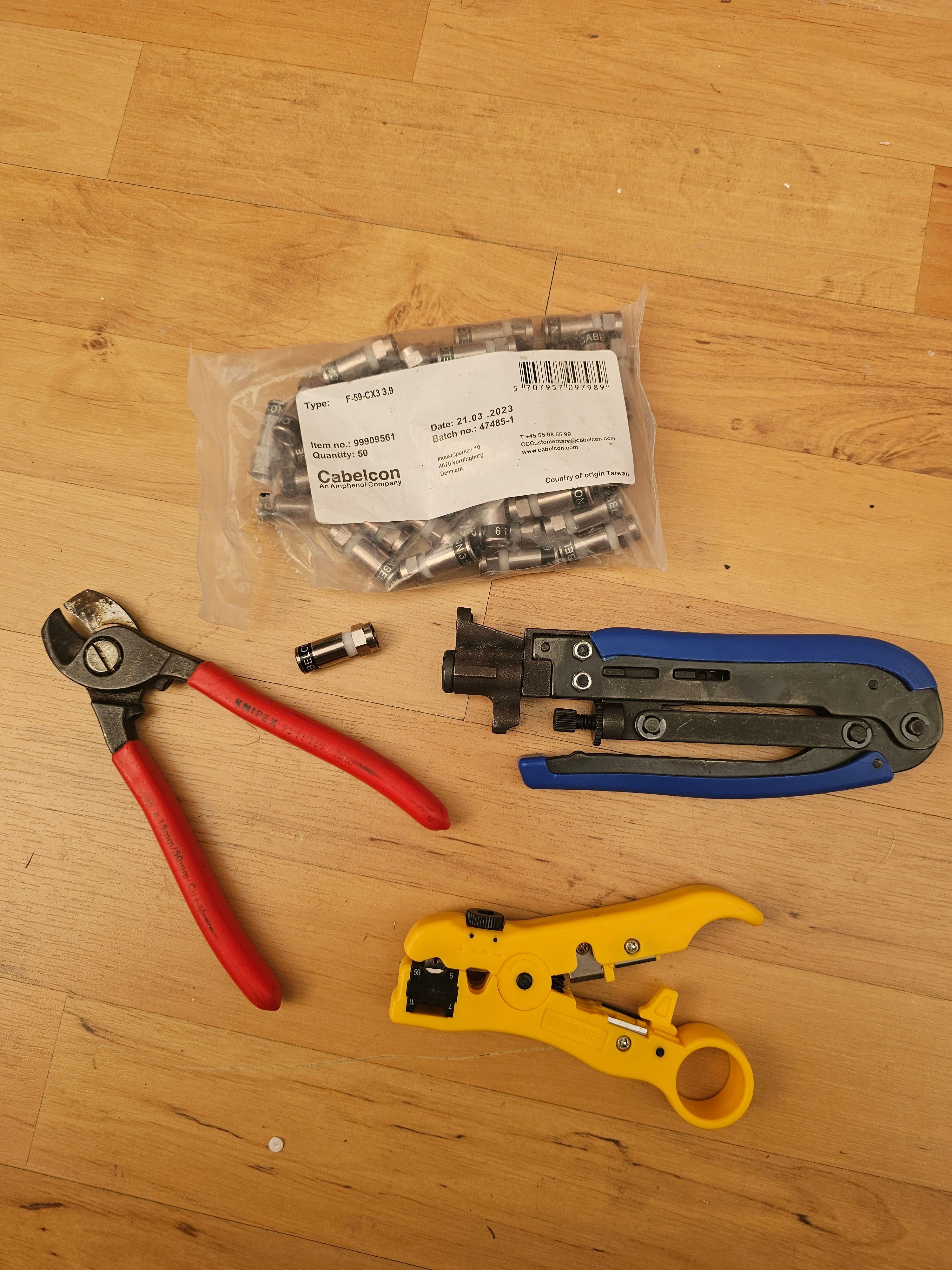

Hi,
Home DIY'er but employed in Aviation industry as a tech so am 'on the spanners'.
I need some extra cables and figured I would DIY.
Do Vigin installers use a specific tool to push connectors onto coax prior to crimping F Pugs ?
I have the RG59 Virgin coax  and some Cablecon F-59-CX3  3.9 push fit connectors.
I have Coax stripper and a push fit crimping tool.
I have found it really difficult to push the connector onto the coax. It looks like the inner sleeve inserts between the Coax wire braid and the foil sheild.
I have managed to make one good connection which took a lot of effort pushing the connector on.
The last installer made the connections in seconds however forgot to take photos of the pliers etc he used.
Any recommendations ? Do you use flaring tools to open up a gap between braid and foil ?  🤔 or do I need to just push harder  🙂
