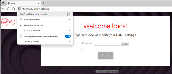

How to sort of make hub 5 have a certificate
Its a trick really you can't put certificate on a hub but you can use NGINX to have it a valid certificate then connect back end to the hub.
So what you will need to do is make a DDNS I got hub5.cable-modem.org then you need to get a certificate I just when for 90 days then you either need to set the DDNS IP to what will be the NGINX setup in my case on Linux Mint or if you have a DNS server change it their. Next you install NGINX at the terminal:
sudo apt install nginx
Then because of Linux Mint open as root go to /etc/nginx copy the certificate and key over then open up nginx.conf
my config looks like this
user www-data;
worker_processes auto;
pid /run/nginx.pid;
error_log /var/log/nginx/error.log;
include /etc/nginx/modules-enabled/*.conf;
events {
	worker_connections 768;
	# multi_accept on;
http {
	# Basic Settings
	sendfile on;
	tcp_nopush on;
	types_hash_max_size 2048;
	# server_tokens off;
	 server_names_hash_bucket_size 64;
	# server_name_in_redirect off;
	include /etc/nginx/mime.types;
	default_type application/octet-stream;
	# SSL Settings
	ssl_protocols TLSv1 TLSv1.1 TLSv1.2 TLSv1.3; # Dropping SSLv3, ref: POODLE
	ssl_prefer_server_ciphers on;
	# Logging Settings
	access_log /var/log/nginx/access.log;
	# Gzip Settings
	gzip on;
	# gzip_vary on;
	# gzip_proxied any;
	# gzip_comp_level 6;
	# gzip_buffers 16 8k;
	# gzip_http_version 1.1;
	# gzip_types text/plain text/css application/json application/javascript text/xml application/xml application/xml+rss text/javascript;
	# Virtual Host Configs
#	include /etc/nginx/conf.d/*.conf;
#	include /etc/nginx/sites-enabled/*;
    ssl_certificate      /etc/nginx/certificate.crt; # Update with your SSL certificate path
    ssl_certificate_key  /etc/nginx/private.key;    # Update with your SSL key path
    ssl_protocols        TLSv1 TLSv1.1 TLSv1.2;        # Adjust protocols as needed
    ssl_ciphers          HIGH:!aNULL:!MD5;
server {
    listen 443 ssl;
    server_name localhost;
location / {
        proxy_pass https://192.168.100.1;
            proxy_set_header Host $host;
            proxy_set_header X-Real-IP $remote_addr;
            proxy_set_header X-Forwarded-For $proxy_add_x_forwarded_for;
            proxy_set_header X-Forwarded-Proto $scheme;
Then run
sudo systemctl restart nginx
and go to the hub by your DDNS
