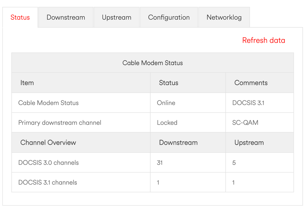

Perhaps you could post the modem stats (upstream/downstream & network logs). Then we might spot something that isn't right.
We'd be looking for upstream modulation fluctuations or high power levels.

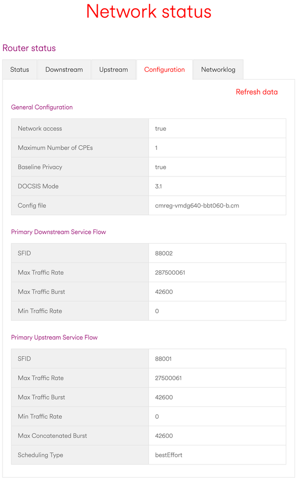

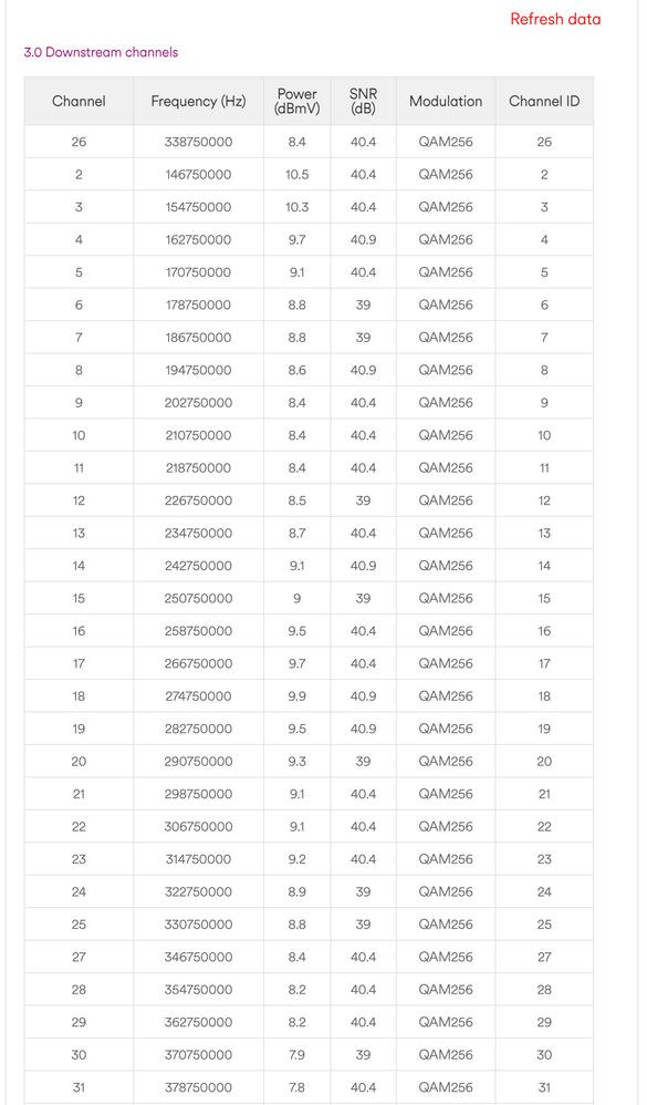

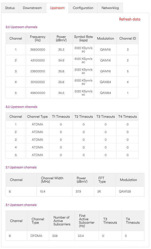

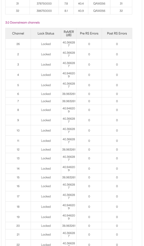

Thanks the the reply, i've attached images for the stats and logs (if there is a better way to add this info, please let me know).

The upstream is a delicate thing. For a start, the channels operate in a noise-susceptible part of the RF spectrum (which is why you don't see high QAM numbers on the Docsis 3.0 channels). Also, the spectrum is confined to a 5 to 65 MHz range into which all users in a locality must fit, the allocated range varying from segment to segment.
When you want to transmit on the upstream, you request what is known as a "mini-slot". You'll get the first available mini-slot and that will allow a number of symbols onto the upstream, and so on until all your data has been sent. You can imagine how congested that might get at peak times - notice might.
