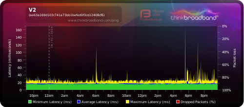

    I have taken a look at our side and everything is look fine right now, can you do me a favour and post your BQM here so we can look please.

      Hi Matt,
      here it is. Really frustrating as it constantly drops out so hope this sheds some light.

        Hi Keirbreakwell
        Thanks for coming back to the thread.
        You do need a tech visit as your downstream power levels are out of spec.
