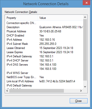

    Once the laptop connects to the VM Hub inspect its network connection properties.
    The key fields are
    IPv4 Address : a value in the 192.168.0.xxx range
    IPv4 Gateway: 192.168.0.1  is expected for a Hub in Router mode.
    IPv4 DHCP Server 192.168.0.1       ditto
    IPv4 DNS Servers 194.168.4.100 & 194.168.8.100
    Below is the Wi-Fi adapter of my HP Workstation for comparison :
