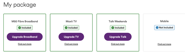

However, I've had a look at their online package and was surprised to see their monthly price is £80+ and it looks to me like broadband has been added to their package at some point? I don't know how this could be as they have never requested nor used it - all I can think of is when they replaced the previous box with a TiVo in around 2019 and the lady on the phone told them they'd have to have a phone line put in but didn't have to use it. I can't check by going into "change your package" because it goes to a "something went wrong!" page.

    I have been informed that essential (M50) Broadband is being provided for people with TV only contracts, in order the replacement boxes will work. It might be why the OP has this showing on the contract.
    • sketchymagpie's avatar
      sketchymagpie
      Thanks, on the contract it says “Free Broadband for TV” so I presume that’s what it’s referring to.

  • Here’s an update. Engineer came yesterday and did indeed fit a “dummy” hub (as in a hub with free internet so the V6 box will work, but which can’t be used for regular paid Broadband) and everything works now.
    However, he was also surprised that they didn’t have Virgin Broadband because apparently their account shows that they have a router despite never having been sent one and never having asked for Broadband to be added to their package, so I need to investigate that for them now.
