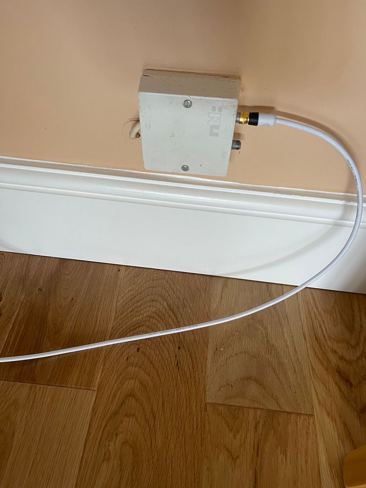

Coax cable connection to V6 box
Hi all
We've had some work done and the builders removed the coax cable that was connected to the wall socket where we had an extra V6 box plugged in. So I bought some cable from B&Q and reconnected the box but there is no signal on the box. It's an old Ntlworld wall socket (see photo) and has two different female connectors. I've tried plugging the cable in both connectors but no luck.
I recall that the old cabling we have in the house is RG59. Do I need a special cable, not the one from B&Q?
Any help most welcome!
4 Replies
    VM use special triple screened cable to stop noise ingress. Best to get a tech to supply new cable and check power levels etc. If you introduce noise with a non standard cable it will affect all users on your street cabinet.
  • Solved!
    The box having been out of action for a few weeks was updating itself - seems not to tell the TV this, so the screen was black.
    Lets just hope your B&Q cable is as good as the official VM one.  😉
