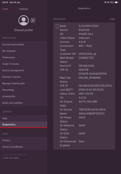

I use the Virgin TV Go app, all settings/permissions are enabled and the app is up to date. Here are the diagnostics:
Build: 5.15.10710+16106
Device: iPhone15,5
OS: iOS 18.3
Video Player: Unknown
Conviva: 4.0.41
Connection Type: WiFi - (N/A)
Customer HH: 131783464_gb
Mqtt Broker Status: CONNECTED
REMOVED
CPE 1 ID: 3C36E4-EOSSTB-003722701400
Mqtt Cpe Status: ONLINE_STANDBY
CPE 1 IP: 192.168.0.62/255.255.255.0
Last MQTT status check: 2025-02-12 22:05:38 GMT+00:00
CPE 2 ID: 000378-EOSSTB-004176098608
Mqtt Cpe Status: ONLINE_RUNNING
CPE 2 IP: 192.168.0.55/255.255.255.0
OV: 4.2.33
OV Engine State: AUTH_FAILURE
OV Device Name: 20F7D63C-7319-45AD-B62A-0D8A2FFA8787
OV Power Status: OKAY
OV Network Status: OKAY
OV Disk Status: OKAY
OV Download Enabled: true
This is very annoying. Please help!

  • Morning I’m getting this issue can u help resolve on both my iOS devices thanks
