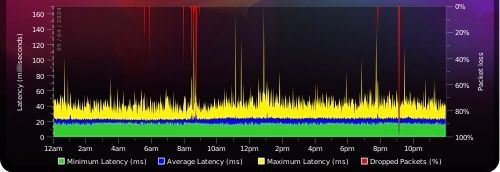

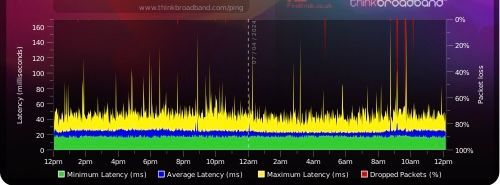

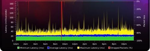

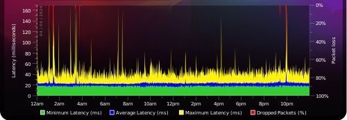

Is this acceptable? Congestion?
This the last four days, been steadily going downhill for the last few months with frequent disconnects some days, none other days. I often can’t access the webui on 192.168.100.1 btw. I’m in modem mode.

    likely too many modems on the upstream or noise causing the data in the modem to try again
  • jbrennand's avatar
    jbrennand
    Cant read the stats - post again as plain text - but its not a typical "congestion" BQM - but there are some issues evident - one of the upstream qams is dropping.  Lets see the other data.  But will probably need a Tech visit.

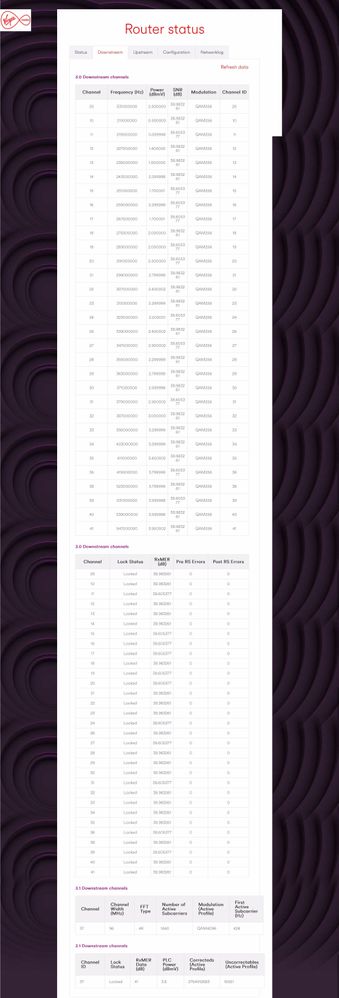

      Service status says no issues:
      3.0 Downstream channels
      253310000005.339QAM25625
      102110000005.138.6QAM25610
      112190000005.239QAM25611
      122270000005.138.6QAM25612
      132350000005.838.6QAM25613
      142430000005.939QAM25614
      152510000005.739QAM25615
      16259000000639QAM25616
      172670000005.638.6QAM25617
      182750000005.339QAM25618
      192830000005.739QAM25619
      202910000005.939QAM25620
      212990000006.239QAM25621
      223070000005.739QAM25622
      233150000005.339QAM25623
      243230000005.239QAM25624
      263390000005.439QAM25626
      273470000005.539QAM25627
      283550000005.339QAM25628
      293630000005.438.6QAM25629
      303710000005.539QAM25630
      313790000005.438.6QAM25631
      323870000005.738.6QAM25632
      333950000005.839QAM25633
      344030000005.839QAM25634
      354110000005.839QAM25635
      364190000005.938.6QAM25636
      385230000005.339QAM25638
      395310000005.339QAM25639
      405390000005.538.6QAM25640
      415470000005.839QAM25641
      Channel Lock Status RxMER (dB) Pre RS Errors Post RS Errors
      25Locked38.98326100
      10Locked38.60537700
      11Locked38.98326100
      12Locked38.60537700
      13Locked38.60537700
      14Locked38.98326100
      15Locked38.98326100
      16Locked38.98326100
      17Locked38.60537700
      18Locked38.98326100
      19Locked38.98326100
      20Locked38.98326100
      21Locked38.98326100
      22Locked38.98326100
      23Locked38.98326100
      24Locked38.98326100
      26Locked38.98326100
      27Locked38.98326100
      28Locked38.98326100
      29Locked38.60537700
      30Locked38.98326100
      31Locked38.60537700
      32Locked38.60537700
      33Locked38.98326100
      34Locked38.98326100
      35Locked38.98326100
      36Locked38.60537700
      38Locked38.98326100
      39Locked38.98326100
      40Locked38.60537700
      41Locked38.98326100
      3.1 Downstream channels
      37964K1840QAM4096424
      Channel ID Lock Status RxMER Data (dB) PLC Power (dBmV) Correcteds (Active Profile) Uncorrectables (Active Profile)
      37Locked415.869125499221235

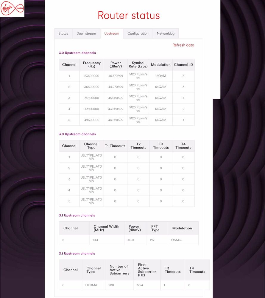

  • The 3.1 downstream channel shouldn't have any uncorrectable errors.
    The 23.6 MHz upstream channel shouldn't be at 16QAM.
    The 3.1 upstream channel should be at a higher modulation than 32QAM.
    Noise on upstream and downstream. Hub may be defective else area network is in need of love.
