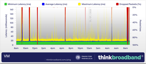

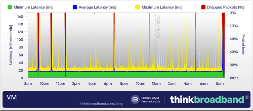

      Spoke too soon, there’s definitely a correlation between TV issues and Broadband issues. I setup the ThinkBroadband monitor, here’s the past 24 hours, though this has been going on for the last 3 days.
  • looks like I was a little to eager in my optimism. Still having issues. I’ve now seen that the issues with the internet almost always coincide with issues with the TV. I setup the thinkbroadband monitor. Here’s the last 24 hours. Though this has been going on for the last 3 days or so.
