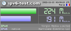

I've just set up a tunnelbroker.net IPv6 connection to my OPNsense router. Some drop off in speed via IPv6 but nothing like the 20Mbps cap seen by others in this thread:
This is using a Virgin Media Hub 5 in modem mode on a nominally 250Mbps plan.
- jamesmacwhiteSuperfast
rowlf wrote:I've just set up a tunnelbroker.net IPv6 connection to my OPNsense router. Some drop off in speed via IPv6 but nothing like the 20Mbps cap seen by others in this thread:
Yes, the Hub 5 having a different CPU and hardware design allows for better performance, It's mainly the Hub3 and below that has issues with 6in4. While the Hub4 is still Intel Puma based, it does have faster hardware which somewhat mitigates the issue in a lot of cases
