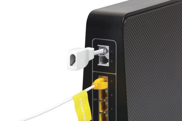

The VM adapter is this thing (in white)
https://www.virginmedia.com/content/dam/virginmedia/dotcom/images/help/Switchover/hub3_rj11_adaptor-...
it does nothing more than convert the RJ11 socket on the hub into a BT phone socket format. It is just a passive connector/adapter (not powered).
