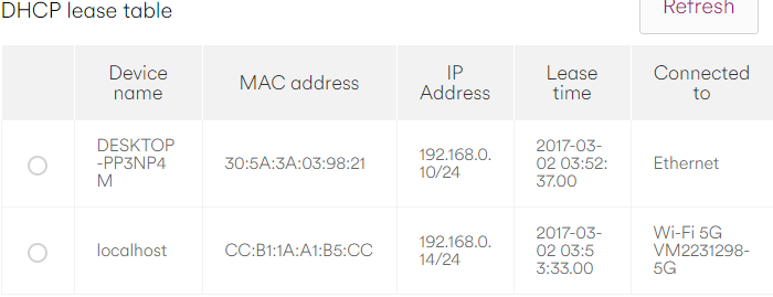

Computer is on IP 192.168.0.10
TV is on IP 192.168.0.14

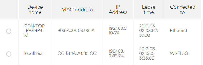

So I check the HUB again - It shows the TV on 192.168.0.59 (Even though I set it as Static to .14

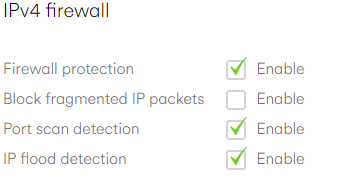

Opened up all the required ports - Still no joy

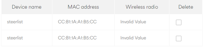

Here's some stuff you guys may want
