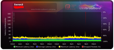

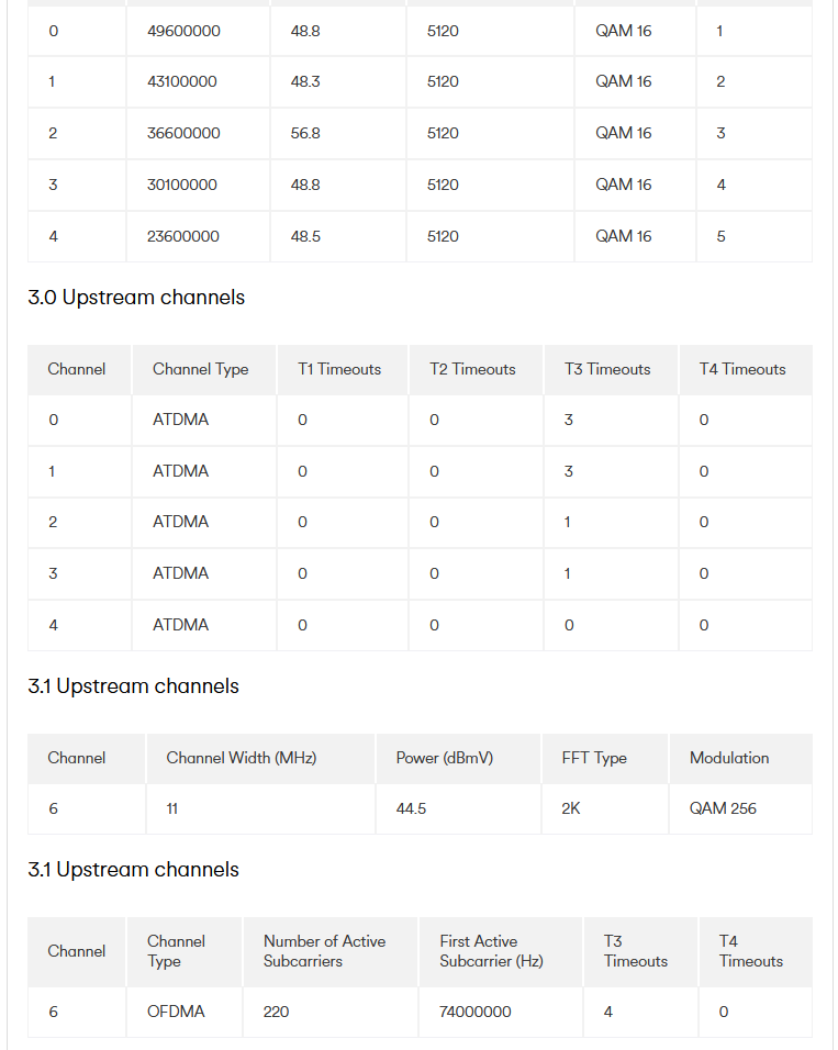

Below is an example of the effect it's having via OBS, a SamKnows test during a drop, and the BQM up until around 5pm today where I reset the router (denoted by the long red line). Current BQM is slow but sort of working. Of course, upstream router status also included. Can include downstream too if needed.
The only saving grace right now is that there is reportedly a TV-related issue in my area. However I don't know if that means that broadband is also acting up. It doesn't say so, but TV's require internet so who knows. Hopefully it's that, I guess. https://www.thinkbroadband.com/broadband/monitoring/quality/share/15c159f4b7fdddf9dbc370d1b974c0c031c67852-05-09-2023 - Here's the current BQM at time of posting.

    P.S. I am aware that one upstream channel's power has jumped. This is not a constant but happens when the timeouts occur before quickly reverting to be in line with the rest, and seems related (the cause of?) to the CCAP warnings and DRW violations.

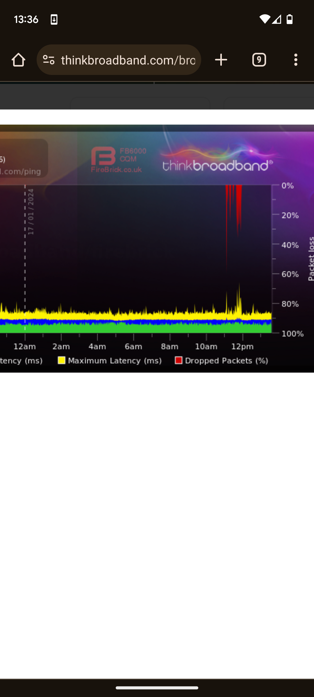

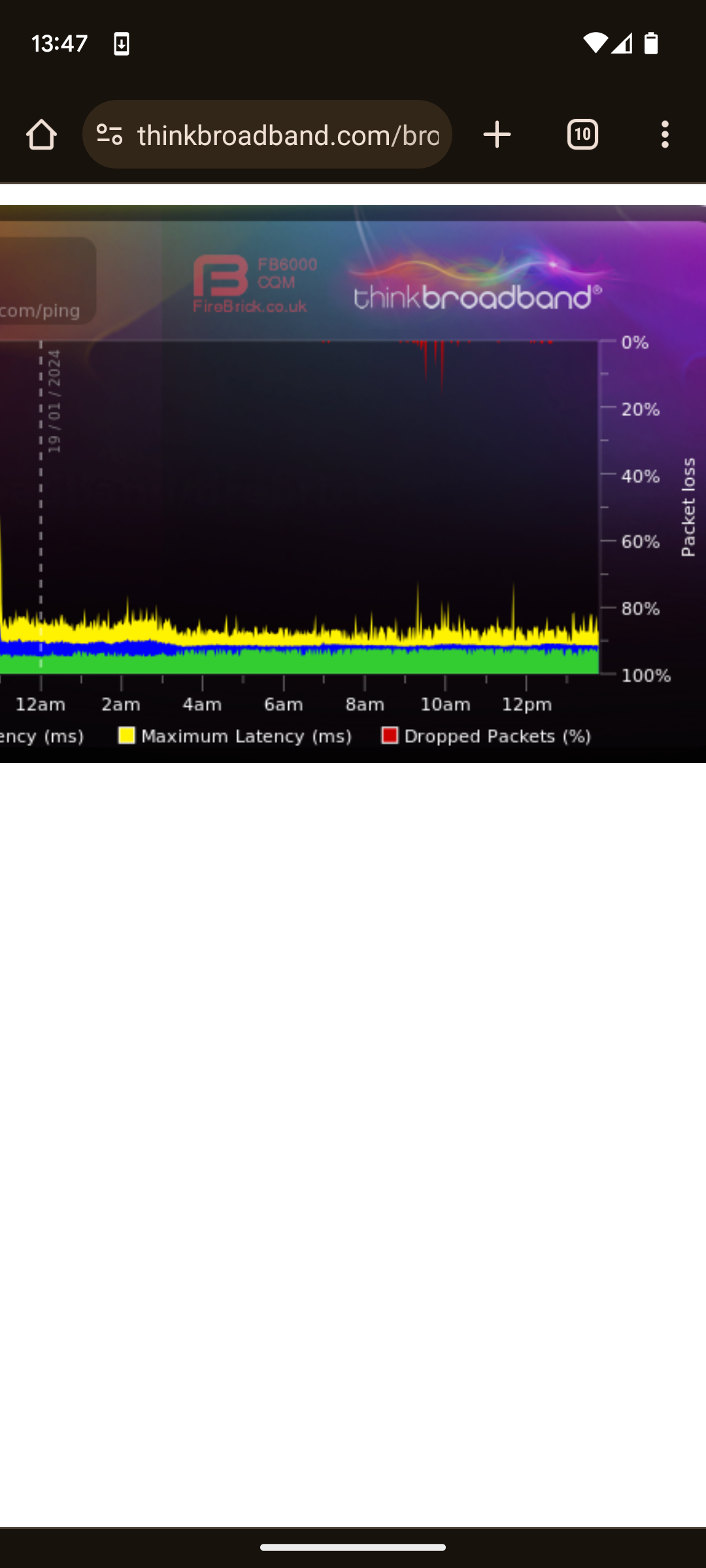

    Exact same problem, exact same errors and stats as have been posted countless times up until this point. This thread has it all already, but now you can include the last 3 out of 4 days as the timeouts and commanded power errors have all appeared alongside the dreaded 16 QAM across the board. This is 100% a VM network issue as it has been every single time these particular errors have occurred (SNR faults), and my connection is 2-3 months old or newer from cab to router by now from the RG11 repull to every single cable being replaced and checked, countless replacement hubs and connectors being inspected. Absolutely no way it's us, no configuration has been changed, everything is in spec and an engineer is not going to be able to fix it as made evident by the 8 I've spoken to over the duration of this thread who are clearly not able to fix an issue that isn't there (at the property), nor are they responsible for issues happening in the area. Below is the Live graph so you can see for yourself. Since the 12th, 3 out of 4 days have had a very large spike in packet loss accompanied with all the bells and whistles this thread mentions already. Our IP has also changed around that time, so I do wonder what networks are doing.
    https://www.thinkbroadband.com/broadband/monitoring/quality/share/fa30b77bf19ed57b33388e686469491dcb3005d8

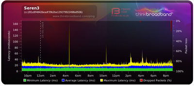

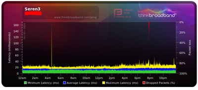

    Since the Live Graph doesn't want to update too well, here are the 3 different days. Pattern seems quite clear to me, and issues in the property are typically more erratic. I've provided the network log with todays problem just for clarification's sake. Please forward this to network so they can traceroute themselves.
