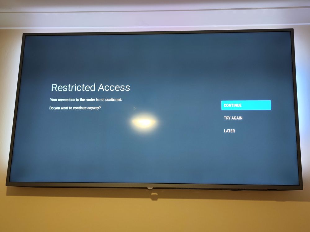

Philips tv restricted access to Virgin Hub 5
We have recently had the virgin hub 5 fitted. When connecting 2 of our Philips TVs we get a Restricted Access message. The tvs and programs we try running are buffering each time we try to watch live football any ideas.
The other tvs in the house connect to Hub 5 without any Restricted Access message. The service we used before this was not a Virgin Hub 5 and we had no problem with any of the tvs no restricted access messages.
The router is pushing out plenty but there seems to be some sort of bad set up between the router and tvs.

      Hi Once again thanks for your help. I put the Hub 5 into Modem mode and followed your instructions. It booted up and the colour on the Hub 5 is yellow at the bottom ( im color blind so could be green ) Plugged the TP link in and logged into the TP Link router ( set it up before turning the Hub 5 to modem ) and we have wifi speeds of approx 300mbps on my phone close by. After setting the hub and new router I done a factory reset and unplugged the Philis tv from the wall left it fo a few min. Once again the tv message comes up as restricted assess nothing different from the existing problem so back to where I started. This has only happened since changing to Hub 5.

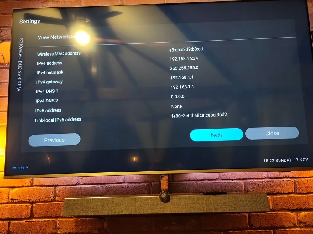

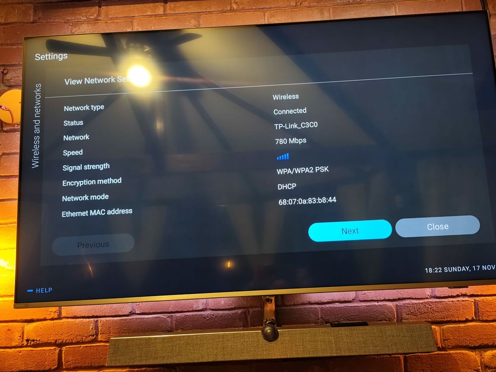

    Might you also photograph/paste the two Network Settings pages from the TV when wirelessly connected?
  • Sephiroth's avatar
    Sephiroth
    Those settings are as they should be.  How far have you researched this problem on the web?  For example, to get out of the restricted mode takes some timing skill when resetting the TV.  As in:

      Thank you for the information. Im not getting a message of restricted access when I unplug and do a factory reset the restricted access message Im getting is when Im trying to connect o the internet. I was hoping putting the Hub 5 in modem mode and using a different router would of worked unfortunately not. My remote appears to be different buy tomorrow I will try this and see what the result is.

        Hi I tried this method three times today. Its not like for like I suppose due to the model differences but the reset is the same result erasing everything as it was a new tv. Unfortunately the result is the same restricted assess message when connecting to wifi. Everyone has been very helpful trying to solve this I appreciate their thoughts. I must push Philips for a solution and if nothing else I might have to live with it.
