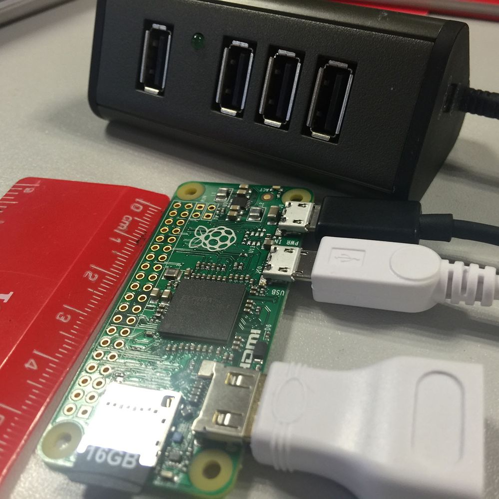

If you want to try and recreate the challenge with Pi Zero you might need a couple of extra bits to attach to the board mainly because every port is tiny:
I found using a multiport micro to standard USB hub easiest for connecting the mouse, keyboard and an additional USB to Ethernet adaptor.
To connect to a screen via HDMI you’ll have to use a mini HDMI to standard HDMI adaptor and depending on your choice of kit you might need to get a micro USB power supply (I used another adaptor as I had a standard USB power cable to hand.)
Tiny ports mean you might need more kit
On the larger Pi & Pi II models the ports are regular so you won’t need to upscale everything.
