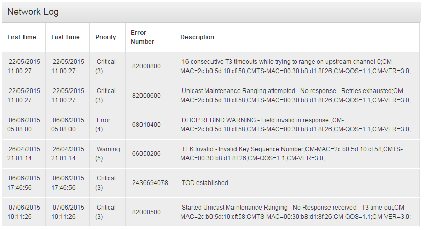

I forgot to add that I'm on a wired connection as is my brother, also here are the network logs and such of the router if they may be of any help:

When? A week a go? Maybe a month a go? I know because if you had done a reboot some days a go even with the SH1 logs show 1 month offset your logs would show 7/6/2015 for the most recent logs and if you did reboot your logs would be cleared which they are not.
